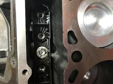

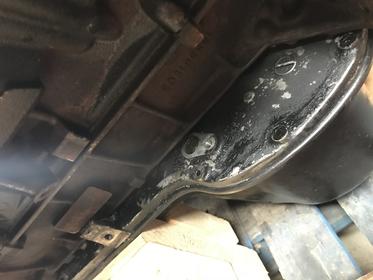

Maybe someone can help here. Are those not Ford pistons in that engine? Is it not covered in oil and dirt?

Here is a few more.

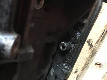

Don’t know why I can’t post bigger pics?

Those are the ford pistons. Look at the crown. It's not a smooth one like on the maxx force ones. Here's a set of coated maxx force ones as an example of the smooth dome.

They do look like Mahle pistons to me, which the ad says they would be Mahle pistons. Don't know about the HD part.

That is correct however I have a PM with airfish stating that I wanted IH pistons not Ford which he agreed to.

In the ad it says hd pistons. And that means International maxx force 7 pistons. Just saying.
