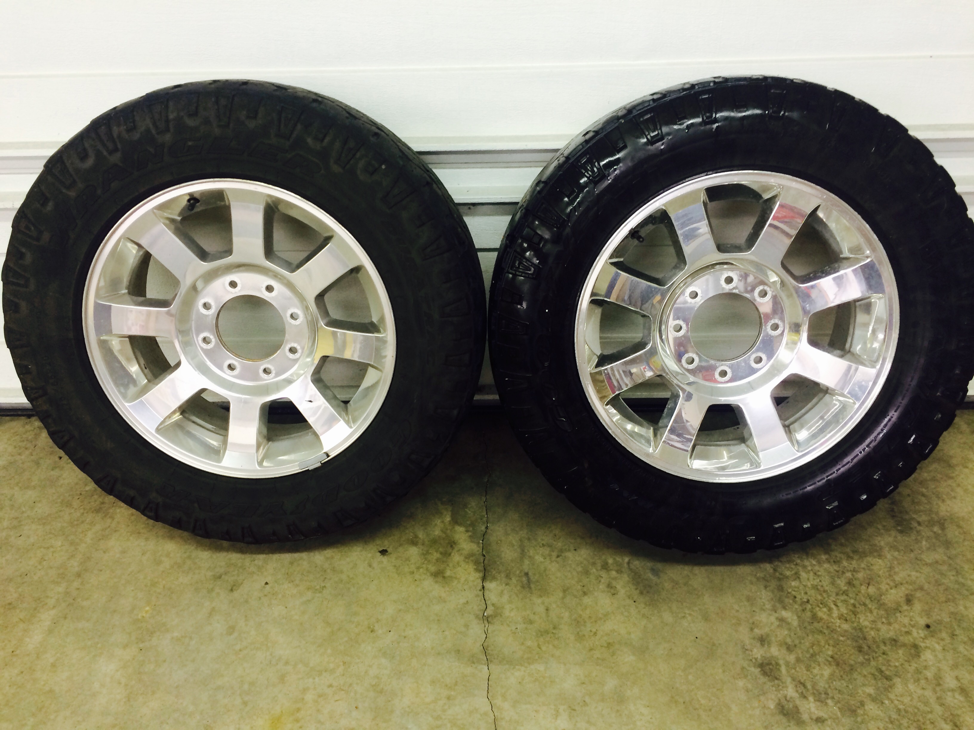

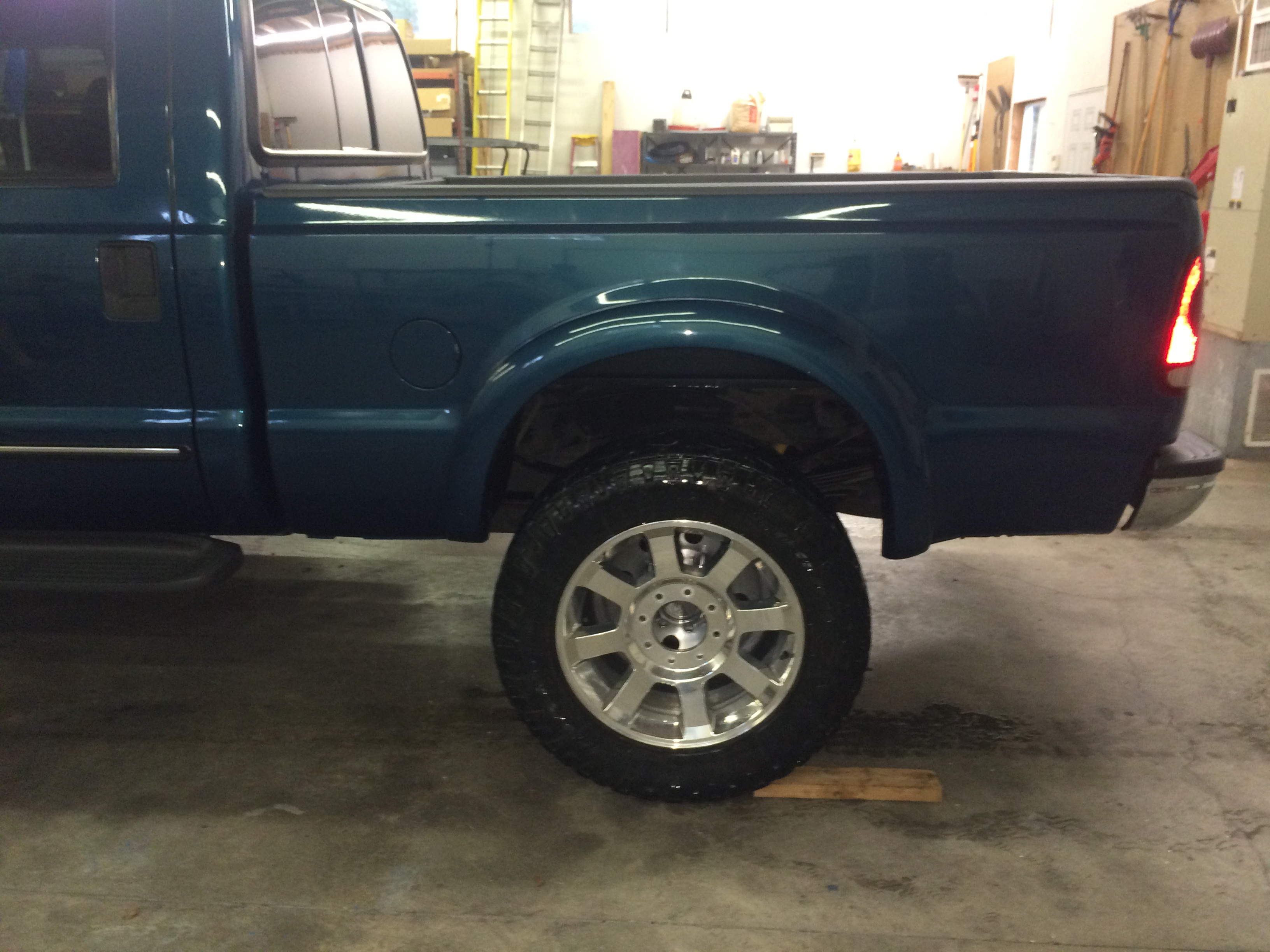

It's going slow-- trying to maintain the commitment..lol. A couple more pics after the 2nd coat of strip and next to an untouched wheel. The pic doesn't show the real difference.
I'm now doing the wet paper-- 800 is working good for basic cleaning.

Well, Im beginning to wuss out. It took 3 hours to run the 800 over one wheel. You can get most of the clear off with the stripper, but it leaves little spots that just dont want to come off and have to be sanded off. If I go for just polish/clear, my plan is to call a few wheel refurb shops to see if they dip the wheels in stripper. If they are powdered, a little media will take care of them.
Once everything is sanded, it polishes fairly easy with a power wheel or buffer to get enough pressure to finish working the metal. I can do the top surfaces but the small wool pad wont get into the holes. Im thinking that a big die grinder and attachments to do it right. However, if you miss one of those little spots of clear it shows up as a dark spot, you have to stop, re-sand and start over.
A few more pics-- the second one is of the sanded wheel that's been polished a little.

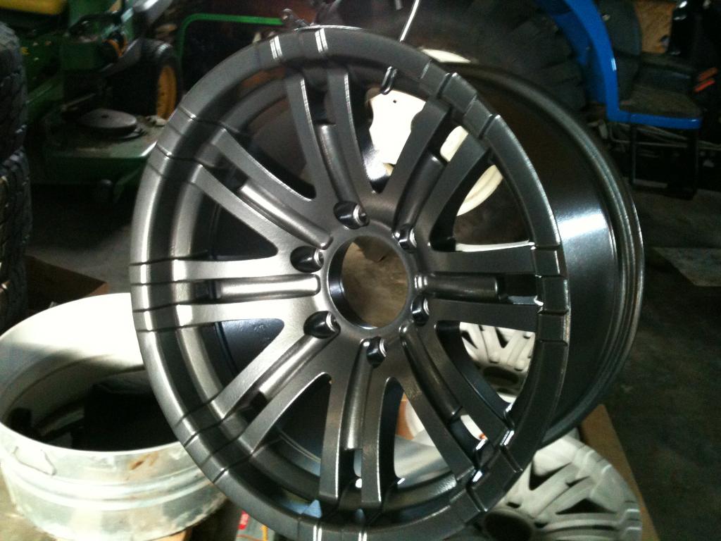

Im going to continue to cleanup the one wheel with the polish, but Im really feeling this argento color...anyone with photoshop skills

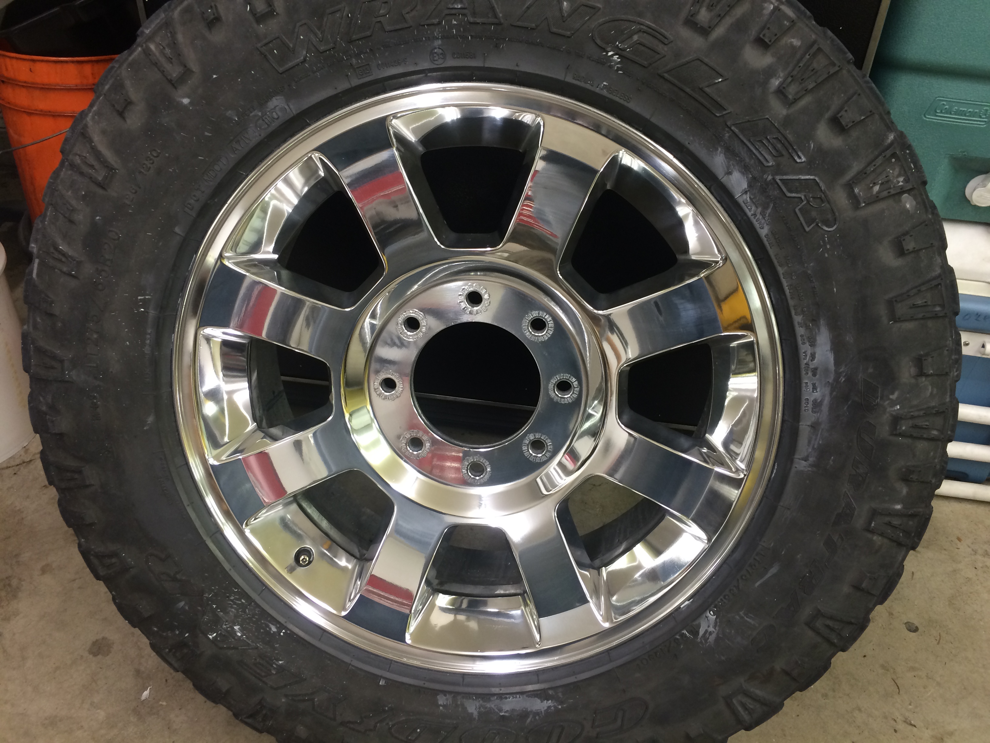

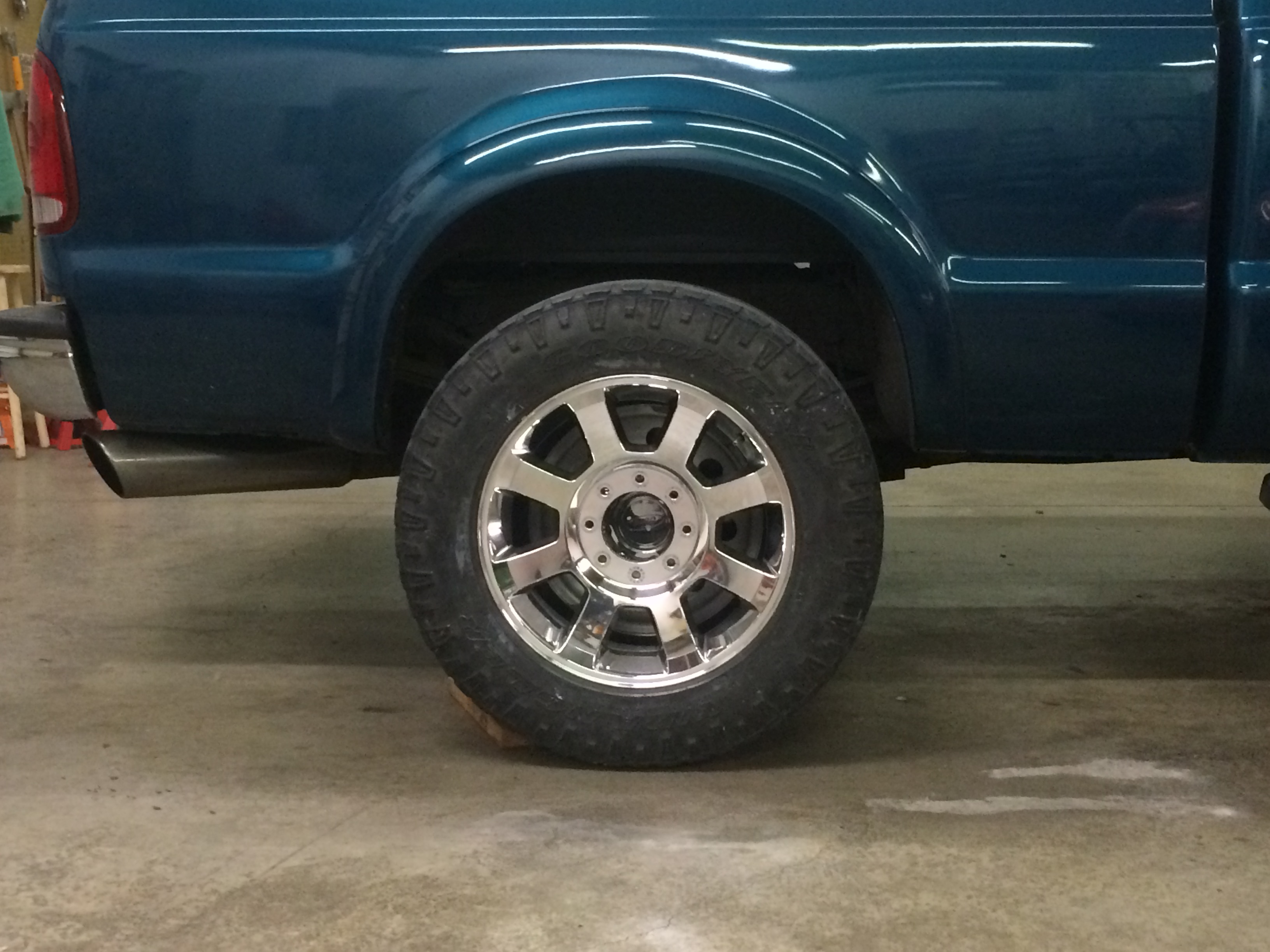

One down and 3 more to go..lol
I'm pretty much sold on the polishing. This color (dark teal) looks so much better with the polished wheel.
I got after this first wheel with the power cone after hitting it with 800. Good investment for $21. It came out pretty good considering I don't have all of the bonnets, etc. Besides, even if I did, it would be surface scratched after the first washing.
I really want to avoid that sanding so I'll keep experimenting with the strippers . It cleans it so good and doesn't hurt to coat it multiple times so I'll keep trying.
Gotta take a couple days off due to the cold weather coming but here's a couple of pics.
