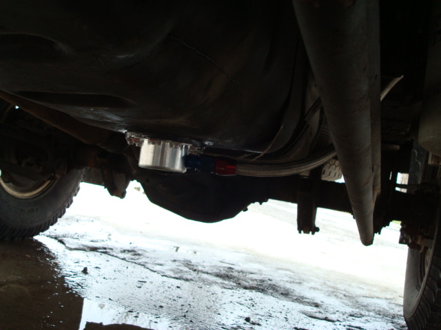

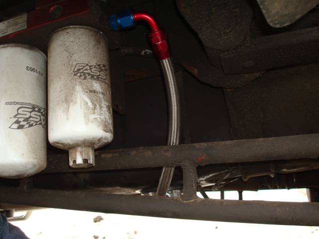

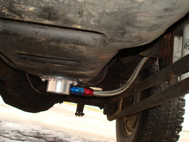

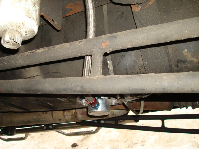

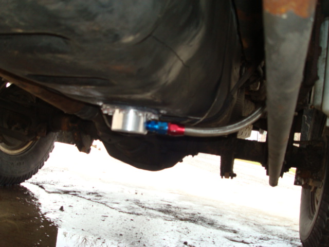

you really don't want the larger pickup tube...they suck. I had a 5/8" pickup tube and it started sucking air little below 1/4 tank. Now i have a hellmann's sump and it's been awesome.

here's pics of mine

not doggin the sump, but ive got a 5/8 pickup tube and i can go all the way down to when the low fuel light comes on. i can even go past if i wanted, and have before. never sucked any air.

Depends entirely on how the large pickup tube was installed. Too far off the bottom of the tank and you will have problems at low fuel levels.
