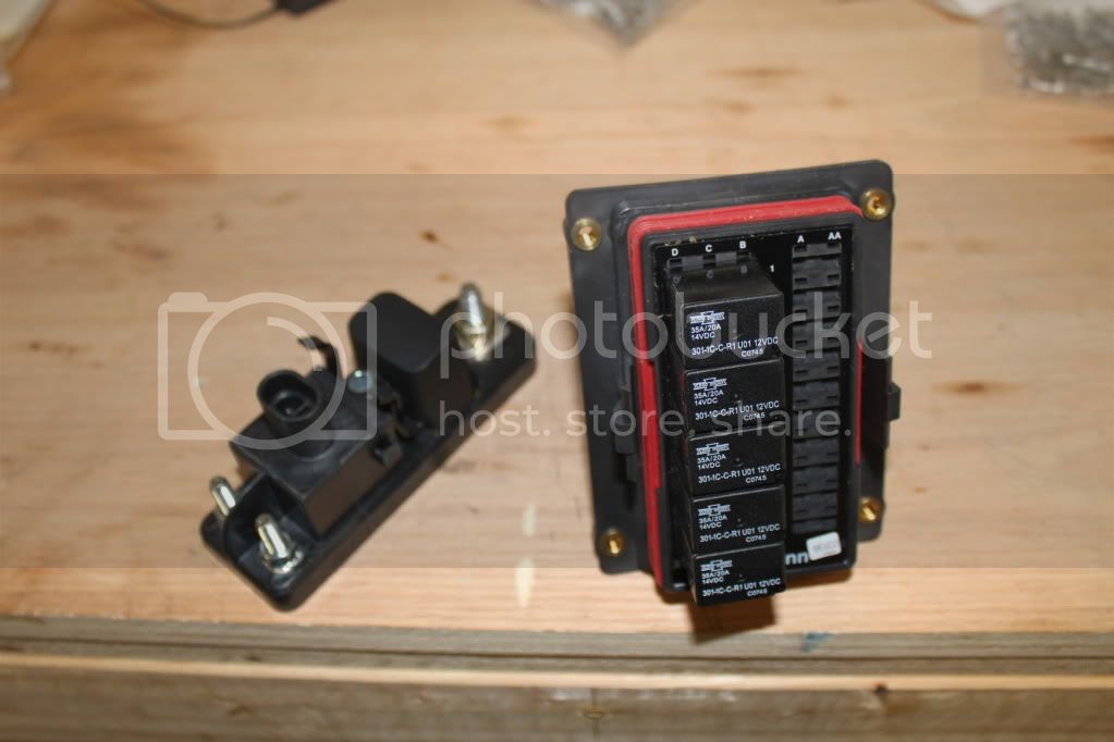

Here's a fuse panel I have under my dash, with about 10 spaces. It is fed by a big plow relay that is triggered with a key on hot.

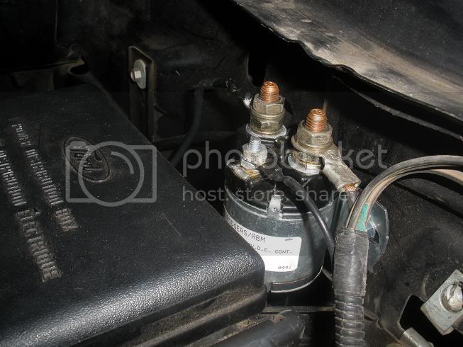

Relay, mounted to the drivers side inner fender.
