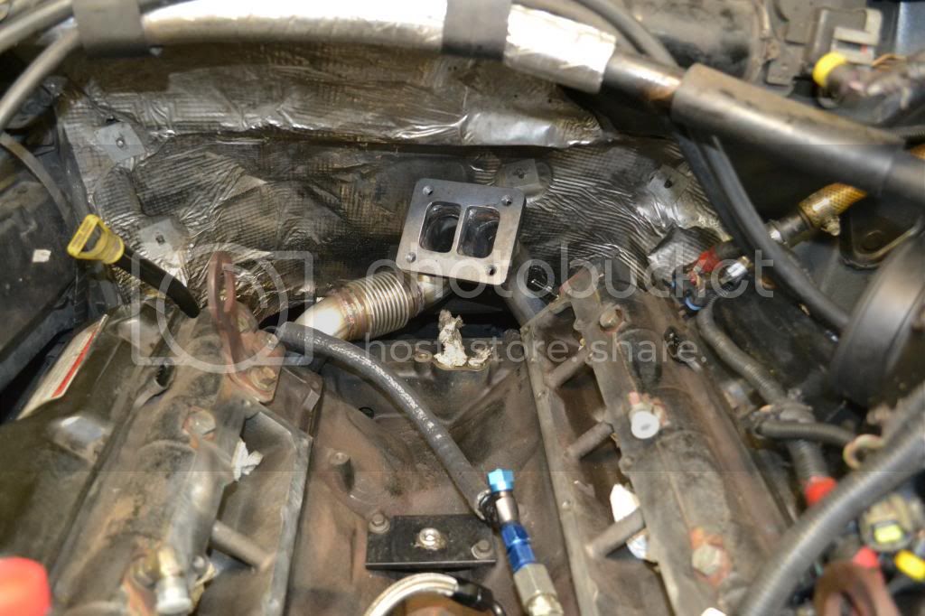

Or bellowed up-pipes from Riff Raff. Nothing about removing/installing the obs turbo is fun so might as well eliminate as many problems as possible while it's apart. Gutted pedestal/flange, bellowed up-pipes, etc..
Ok I see what your saying now. I just went out and took a look. It looks like I already have two pedistal bolts missing -.- that'll make it easier to get off but I'll have to buy some bolts now. What do the bellowed up piped do and how hard are they to install?
I don't think my up pipes leak. Should I replace them anyways? The only leak I see is some soot coming from the turbo outlet. Is there a gasket in there or just the clamp?
For $490 you can have a set of Riff Raff bellowed up-pipes. They are cake to install with the turbo out of the way, you put them together out of the truck and drop them in from the top. Just loosen the trans dipstick from back of the head since the passenger pipe goes behind it, drivers side is easy. It's not the worst job in the world but you'll find out $500 for up-pipes is nothing compared to pulling it all back apart later down the road..
Few tips:
- Eliminate the bottom studs on the turbo collector if you opt to stay with the stock stuff. Having bolts makes it easier to install the turbo
- Grind out the "webbing" on the pedestal above the fuel pump banjo bolt. Makes it easier to get to the bolt when you will be replacing the fuel pump.
- Eliminate the EBPV and EBP flap.
- Anti-seize, anti-seize, anti-seize, anti-seize
