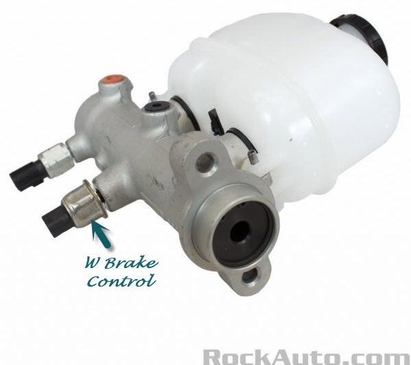

I'm buying parts to replace the brake cylinder, booster, and all lines (i'm buying all the lines b/c IDK which ones - i'll return them if not used)
My question is on rockauto, cylinders:
MOTORCRAFT BRMC25 w/ Hydroboost; w/ Integrated Brake Control
and
MOTORCRAFT BRMC24 w/ Hydroboost; w/o Brake Control Valve
Which one do I need? It's for an 05 Lariat
Just a little confused.
Thanks

My 06 Lariat has the integrated trailer brake controller so the Master Cylinder part number is:
5C3Z-2140-HA

Do you have factory installed trailer brake control module?
Yes I do. After I wrote this I sat and it sunk it. I was assuming it had to do something with the trailer brake sensor.
I’m assuming I need the one with the brake control?!

Yes. If you have factory installed TBC then the master cylinder has an extra sensor for that.

I did some research. Here is the photo from rockauto just in case someone was searching.
