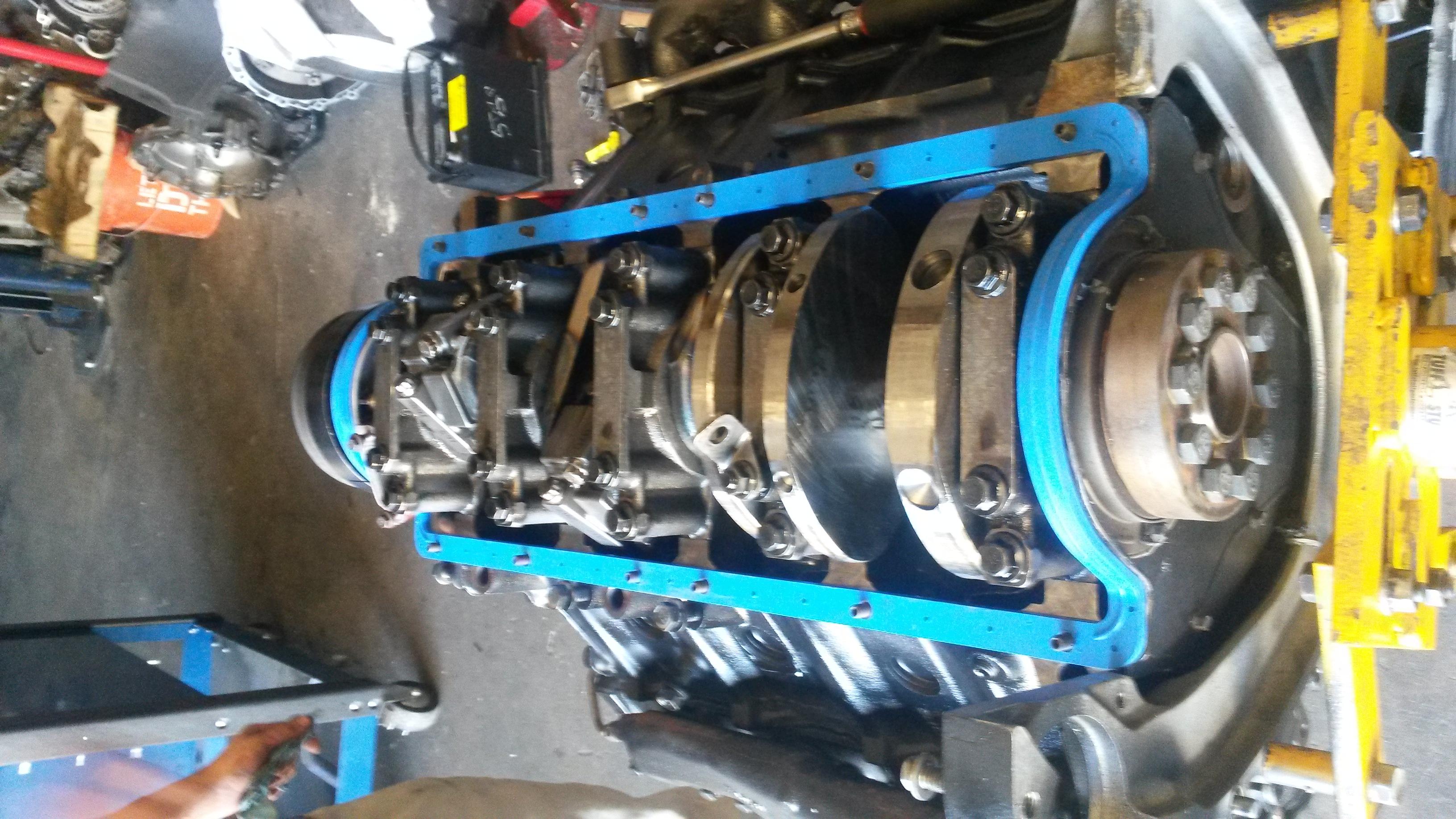

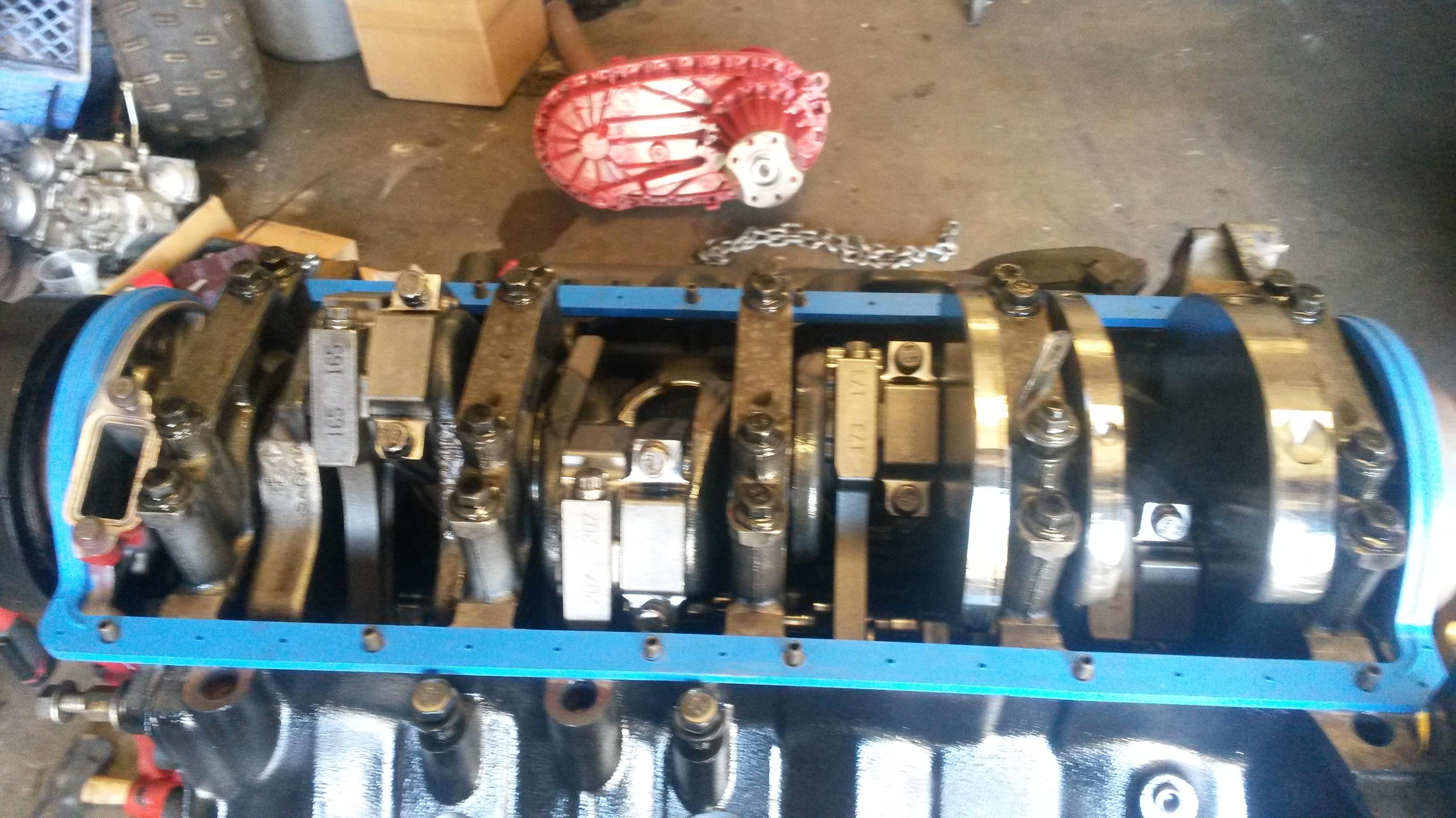

Finally installed the gasket really nice quality thick gaskets and it use stud very nice
