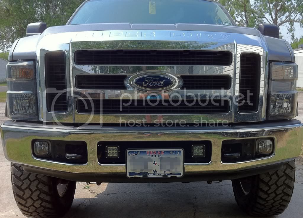

The D2's mount is a square tubing welded to the bumper brackets by a piece of flat iron on each end and the dually's mounts are a piece of I think 2" angle iron with the pattern cut out of part of it to fit onto the other side of each bumper bracket. Also welded. It's hard to explain but if you saw it, it would be real simple.
As for the wiring, the D2's have the hot wires run to the uprights switch #1 and grounds to either the battery or the body. I dot remember but it doesn't matter. And for the dually's which replaced my fogs I just cut off the factory fog light harness ends and the rigid wire harness ends and soldered the rigid ends onto the factory harness. It's just like using factory fogs.

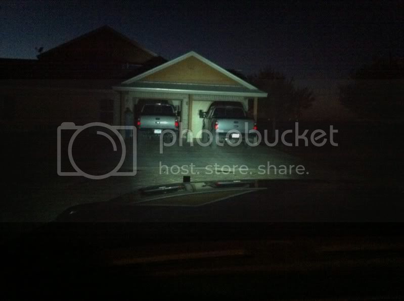

This is 55w 5000k HIDs and Duallys as fogs.

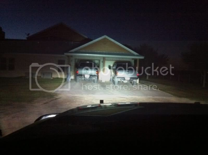

This is just the Duallys
