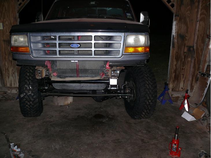

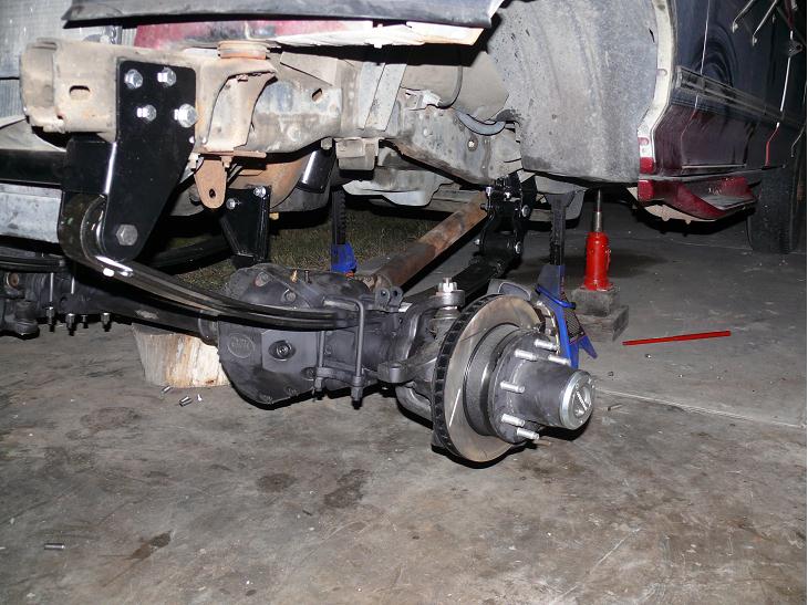

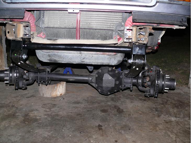

I installed a sky RSK with SD springs on the ground along with a d60 about a year ago. It's not all that hard, just time consuming. You will have to cut all the rivets on the rear hangars then drill the holes larger. You also have to drill a bunch of holes in the front.

Little hint make sure you have plenty of good drill bits too I broke one and burnt two and I took my time with them. The one thing they don't explain we'll enough IMO was the fact that you have to remove all the front hanger components then put the crossbar up front with the existing hole (where the old front shackle bolted to) then measure from thr old rear hanger I think it was 43 1/2 inches then do all of your drilling. I almost blasted off all the rivets on the rear hangers then that would've been fun! Only not at all.
