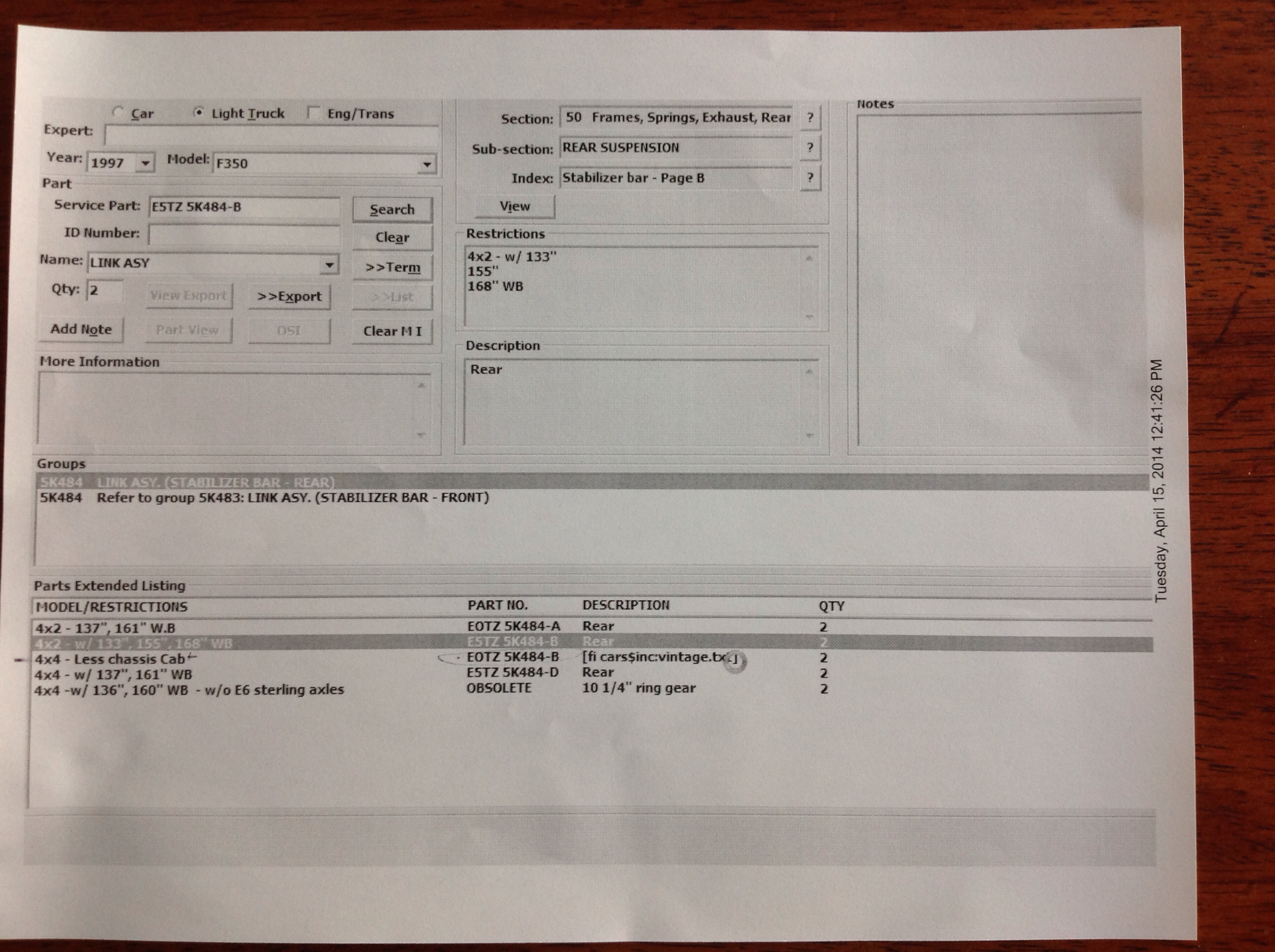

Link breakdown
I was at my local dealership today picking up my new sets of springs and asked the parts guy for some help with obsolete partno. I told him I knew he couldn't order it and wanted to check the vintage parts houses. Attached is the printout he gave men looks like there are actually 3 different partno's that were used. -B is for the 4x4 non can'n chassis trucks. I'll put up a picture at the end and let you know how it looks.

after crawling around under my truck last nite doing the brake line swap, I think I already have the rear ones installed, they look identical, guess I'll know when my others come in, but they are pretty dang long already and oem ford ones.

They look like they are about an inch longer than the factory rear links. I still haven't received my links, but got the rsk, track bar, brake lines and ubolts ordered from PMF today. I'm targeting the 2nd week in May to install all this, rebuild front axle and entire break system. Going to be lots of fun.

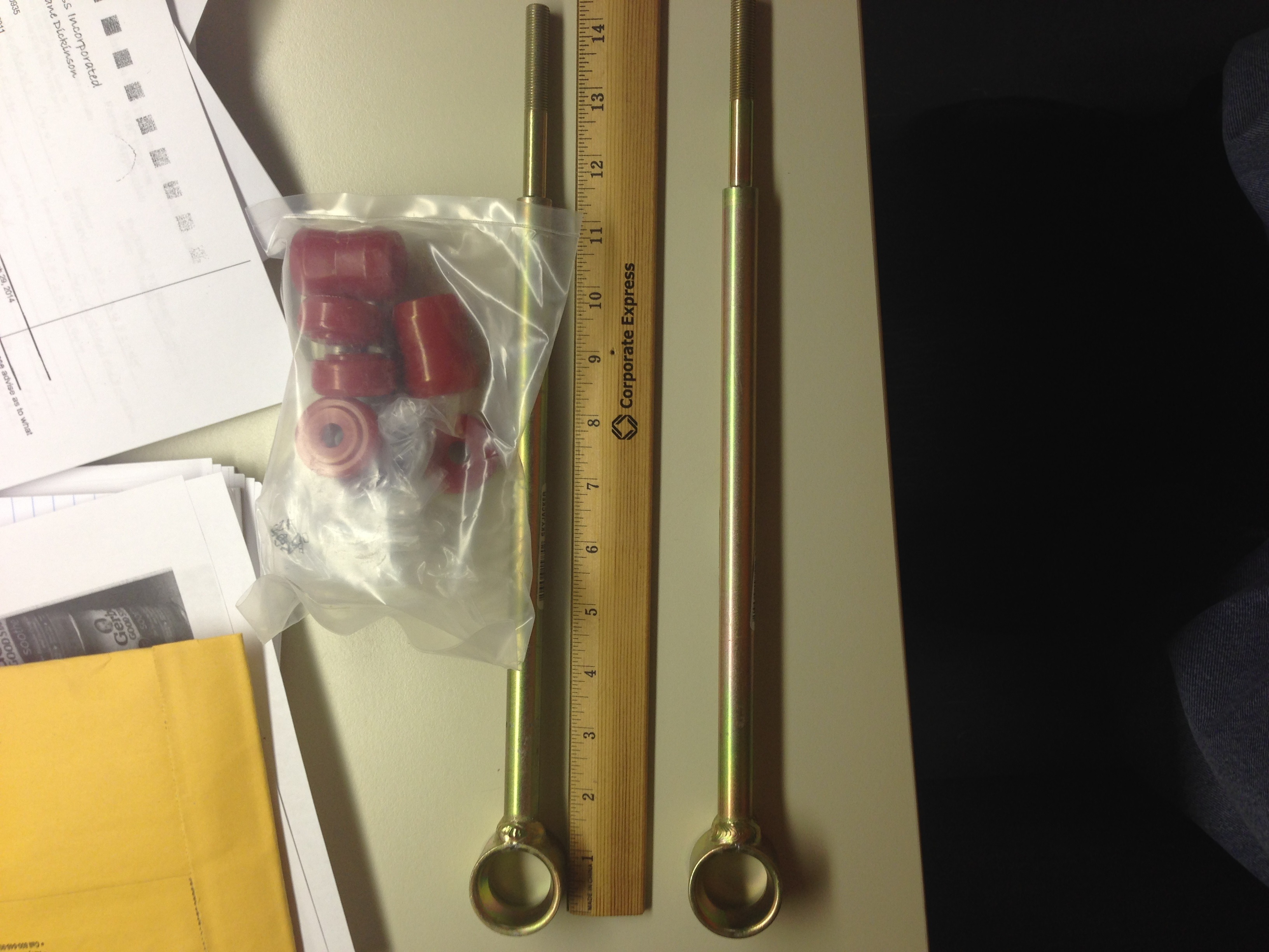

zarrinvz24
Dec 5, 2012
71
Arizona

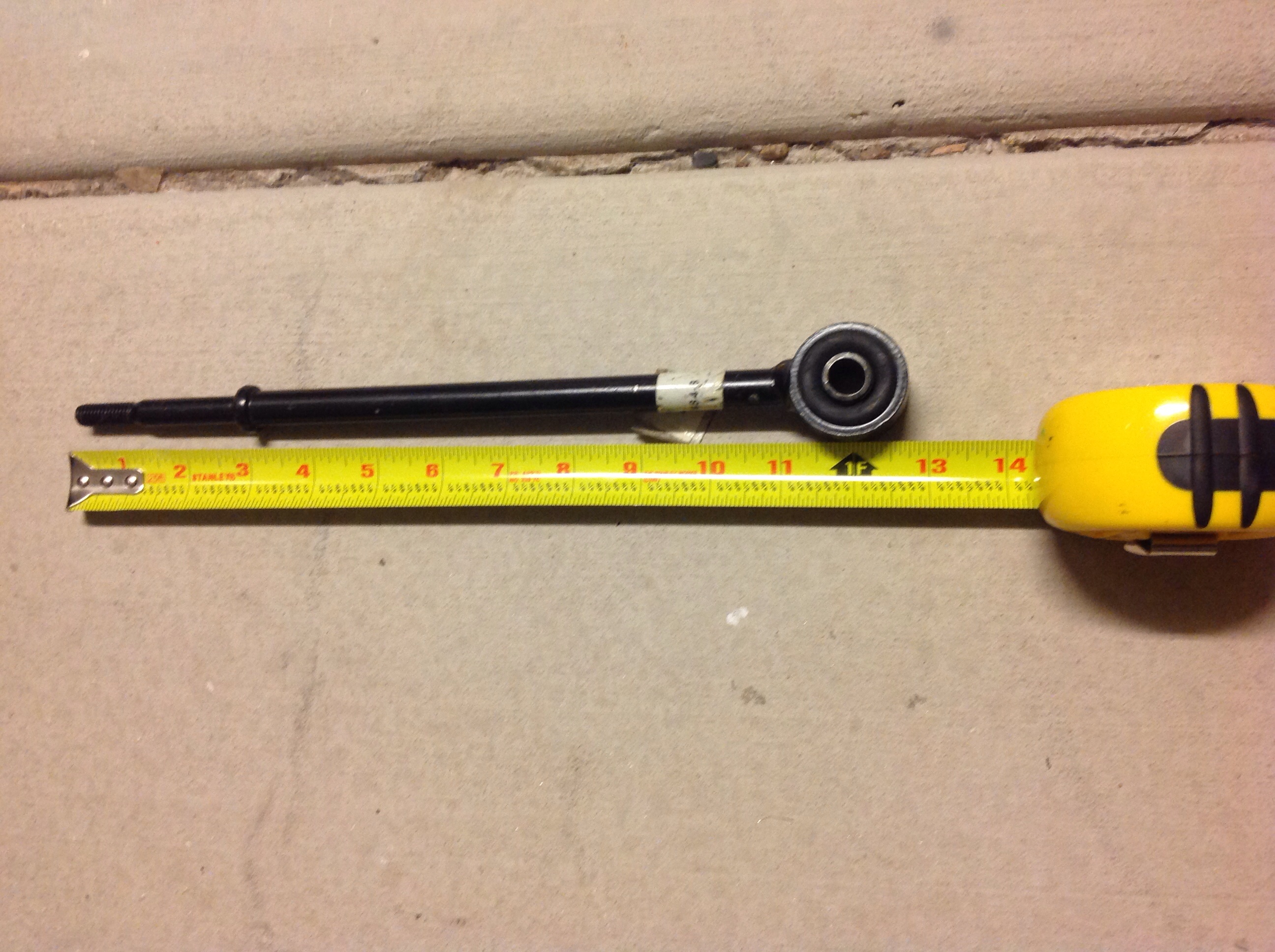

Got the links today, will get a picture up this evening. Quick glance looks like the skyjacker links position the bushings and bar about 1/2" lower than the factory rear links.
zarrinvz24
Dec 5, 2012
71
Arizona
Looks like the skyjacker link positions the top washer about an inch lower towards the ground than the stock rear link would; here is a picture. I think either link will probably work. I'm going to try and use this link with a v code spring up front.
