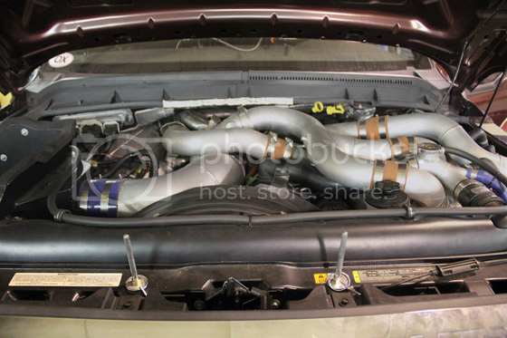

I have the batteries in my toolbox so I could clear my twins in the 6.0, looks a lot better too. That's crazy your cab is off already, you move fast! I would hate life to keep taking piping off and on again for changing out something that used to be easy to get to, must be why you need to do it right the first time lol. It's a 6.7 but you get the idea

Can anyone confirm that that 6.7 is triples? If so, how do they have it plumbed? On most triple trucks there is two atmospheric chargers, both having an air intake. On this truck, you can clearly see the air intake goes right to one charger in the valley. So the atmospheric stage is just one turbo. Then coming out of the atmospheric turbo, it splits. So is it actually going to two small high pressure turbos? Or is it going to an intercooler that has two entrances? If it is triples, I don't believe it is set up in a triple compound set up like the guy is doing on here with the stock compounds and a 91mm, or in the more traditional triple set up where two atmospheric turbos take the place of one BIG atmospheric turbo.
I was looking at that too. Not sure how that setup works.
