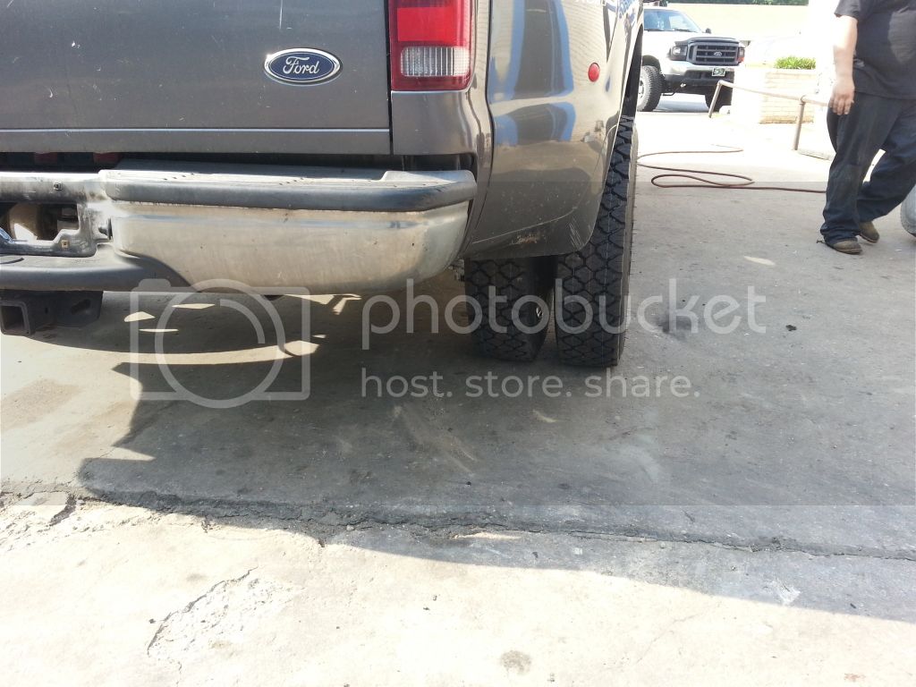

Going to be too much to mess with for only getting the brake upgrade. Putting adapters on rear to run the 19.5" wheels and putting brand new rear Calipers, Pads, Rotors and seals all in rear.
On the front I'm putting in new ball joints, 450 spindles, 450 Calipers/Rotors/Pads, 350 hubs, 450 adapters, 19.5" wheels.

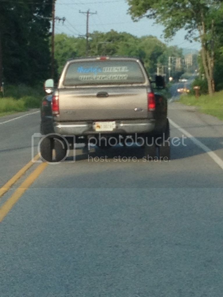

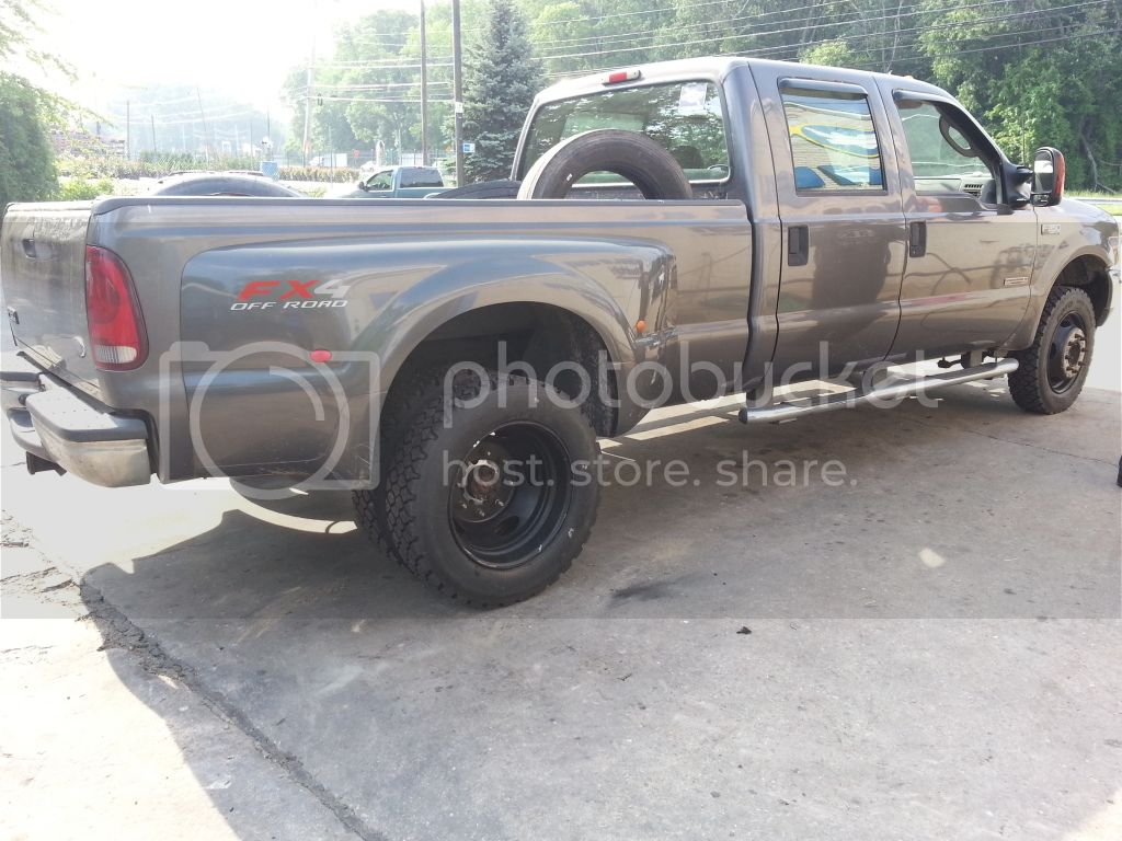

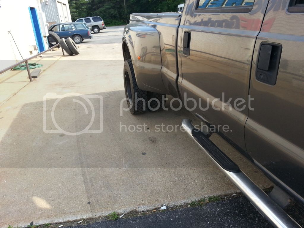

So up front I have f450 ball joints, spindles, rotors, pads, calipers, adapters, wheel and tires.
Out back I have new OEM dually e brakes, calipers, rotors, pads and then adapters. Then using f450 rims and tires.
I needed 6 new 235/85/16 tires and one rim was cracked and another was bent so I needed two dually rims. I can buy 19.5 tires new the same price as 235s. The price of adapters absorbed the price of the two dually rims I needed. Up front truck needed ball joints and brakes. Out back it needed rotors,, e brakes and pads. One caliper was hung up.
I think I pulled the most value out of situation at hand.
