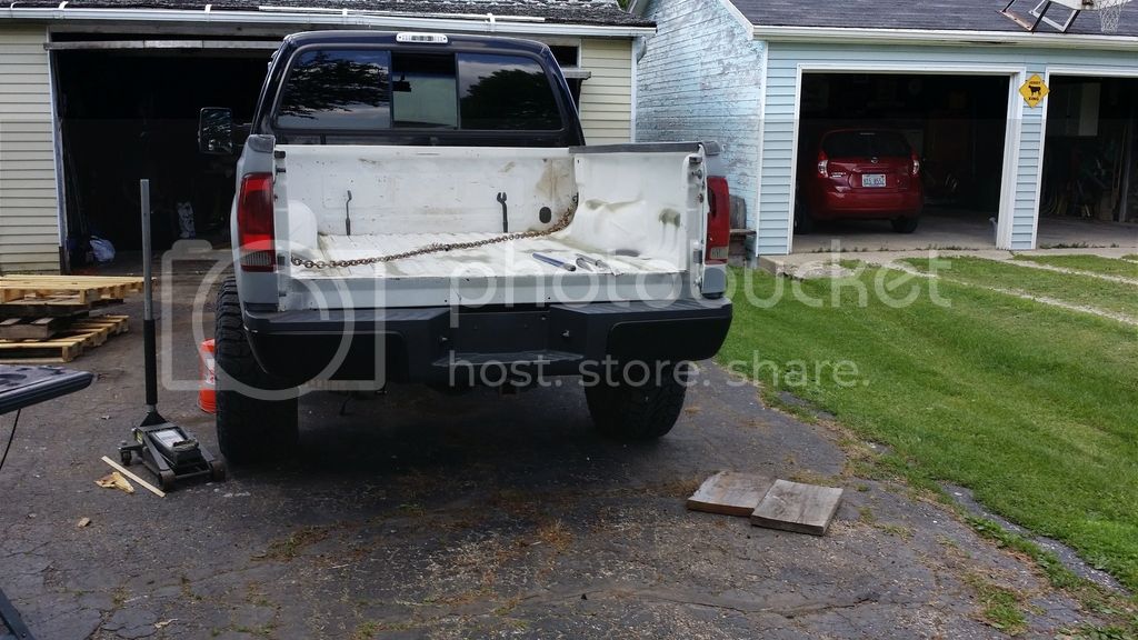

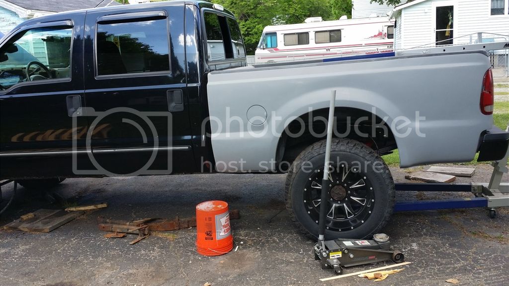

Justin cainer, it appears my math was off a tad. I have a small amount of rake with a 3.5" block (2.5° taper). I flopped the bed and 35s on to see where I was at stance wise. The photos are slightly misleading as the drive runs a negative slope.

And cainer, I may ditch the 250/200s. They do work very well towing with a 2.0 ms tune. Its a "tow" tune which means nothing other than I requested longer shift points and it will downshift on decel more readily if you touch the brakes otherwise it'll ride whatever gear its in. At 2ms it'll run the 38r right up to 38 or 39 psi with that billet wheel. Its pretty nuts. Its when I use other tunes i need restraint lol. Its dumb fast in town. Im just not ready to tune. Too many irons in the fire right now.
Thanks for the info Ty (both this and the ride height stuff). I hear you about "too many irons in the fire". Lol! I'm spread pretty thin myself. If you decide to unload the 250/200's, let me know before hand. Charles tunning would get me close until I get into tunning myself.
I think Joe (Psduser) I might be switching over to a 200% nozzle'd hybrid some time soon. I would love to see what he thinks after towing with them. He's got a zf6 too, so it would be good info for me.
I really want to see if shrinking the injection window while keep mfd really does have an impact on egt's. and possibly rod longevity since most of the stress is applied before rod angle gets too extreme. Haven't seen Charles posting that he has windowed his block with pmr's with that 2ms injection window. :)
