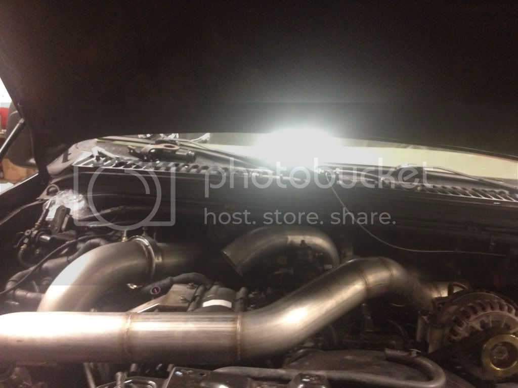

I think he means how he ran it through both turbos before the intercooler. Most setups I have seen intercool between the 2 stages then directly into the motor.
Looks good!!!!
i was thinking i missed a photo showing the primary going to a cooler.
well theoretically it is,so then yes technically bolth stages are cooled. duh

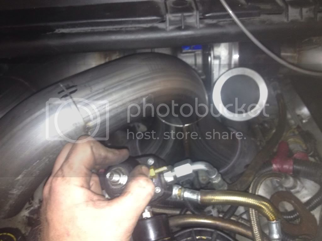

Wonder, would a 38r work well in place of the s366? I guess then you'd have to worry about mounting if you're not putting it in the stock place.

Turbine on the high pressure is 73/80/.90 and the low pressure is 96/1.32
Tycor I'll get some truck pics when she's done cleaned up.
Milford- cost is going to be roughly 5k give or take for someone wanting to do this. I've saved a few dollers by selling/swapping a few things and doing some of the work myself like pulling the pan/turbos/parts doing a lot of small misc time consuming stuff. And getting a used turbo. I'm hoping to get close to 600 with the 250/100's and 650 with a nozzle swap to 200%'s+srp1.1 or twins.

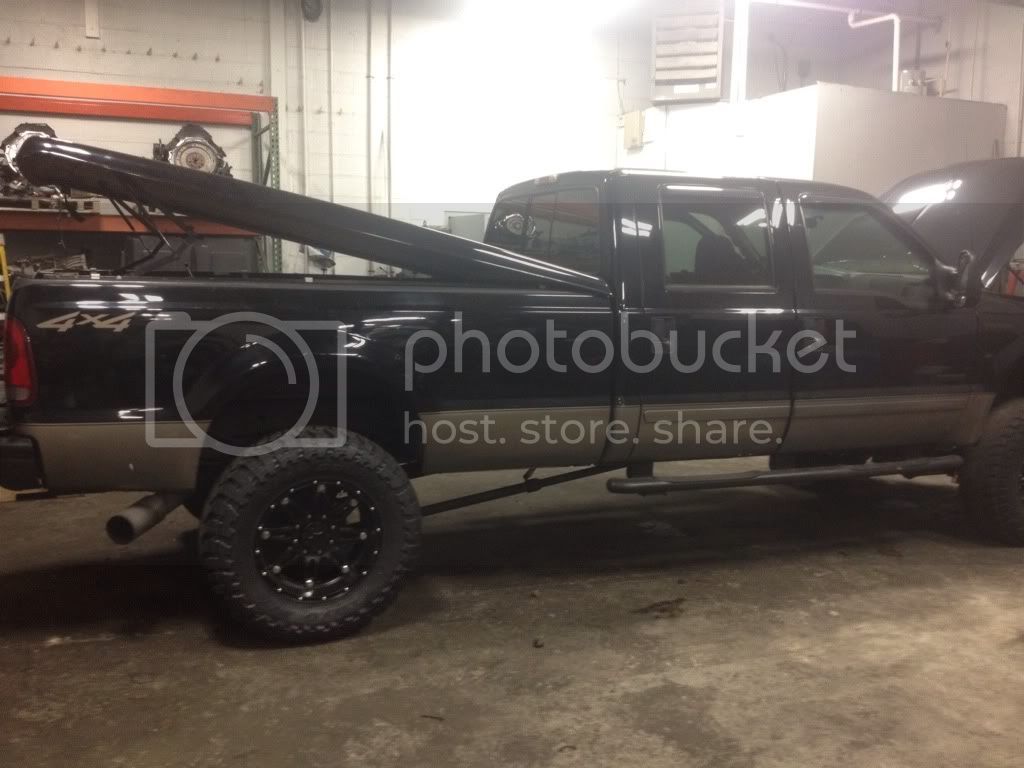

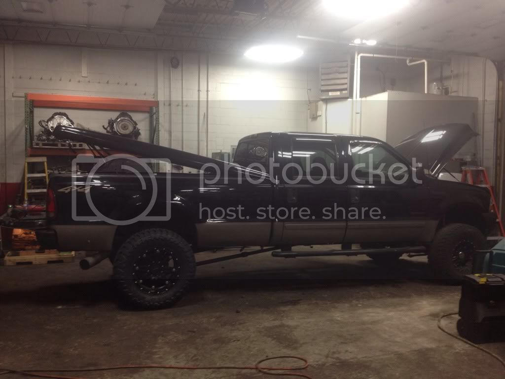

But the goal for this build is to have a super clean, responsive, dd tow monster.

very impressive sir, clean set up. looking forward to the final product. i will be able to refrence this when you are done, ill be doing a very similar build in the near future. my gate will have to go in a different spot though, the s400 is less forgiving on space

@maddiesel-reason I asked for.the pics is I have a black cc/sb with 20x12 throttles(black) and I.want to do tan two tone using the current KR tan as the accent. Looking at your pics, seems like it'll look nice.
Granted Id.take the compound.setup over a nifty paintjob anyday but this truck is.probably gonna.become my dd in the next couple months so its.got to serve every purpose, even hauling.kids around.
Ill definitely be watching.the build too! Your.truck looks nice bro!

Exactly what I wanted. Now how do I get.the paintcode? Or.perhaps.I.should.go record.the.vin off of a new.blk/tan KR. Your truck is nice buddy. Love it. All black has.gotten boring.to me.
