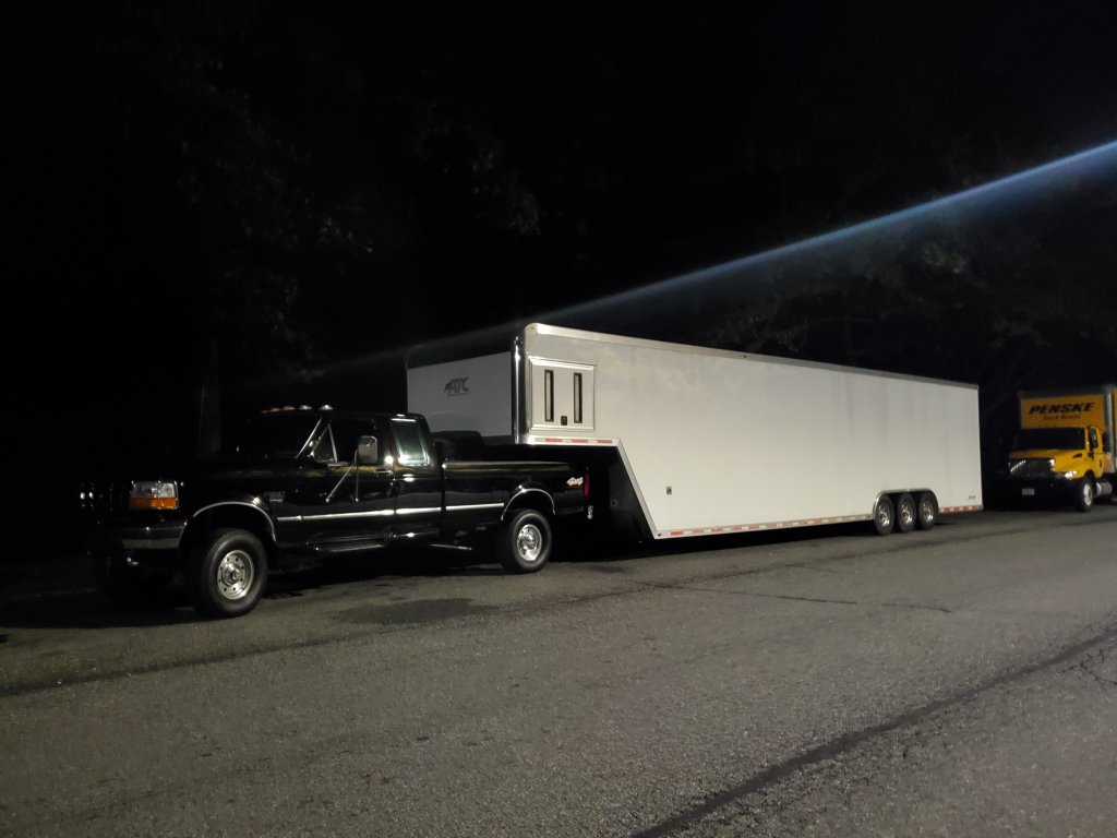

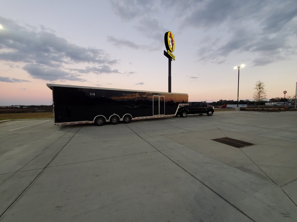

Very old thread, but curious as to how everyone's setups are doing. Mism my ole 96
Doing fine....use the OBS for light towing and day trips. Use the dually for the heavy towing from a safety stand point but the OBS does come out of retirement if need be 💪.
