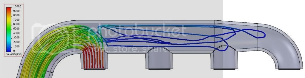

Here are a few screen shots of the flow simulation I did of the header.
The first show the primary made out of a elbow into the collector, the second show straight pipes going into the collector.
The first model(which is how it was built) shows higher exhaust velocity at the exit of the header, and smoother (less trurbulant flow) that the second design.

The sweeping primaries obviously make smoother transistion. Plus, where the main tube is larger than the primaries, you have a long collector. For sure an improvement.
Why are the scales different for the colors ?

Here is a study on individual cylinders. Again this is just a computer flow study. (This is my interpration of the flow study)
Fist set is the elbow primarys. It appears to have less circulation (or dead flow) that he straight primarys, and higher exit velocity. I'm sure that the overlapping of the cylinders would take care of any exhaust recirculation that might happen.
Second set have straight primarys.
They represent the velocity of flow in inches per second. The color changes as the velocity changes. It seems as the two different designs have different scales and they reflect a very close velocity rate for either design. Better get it done and tested real world to know for sure.
