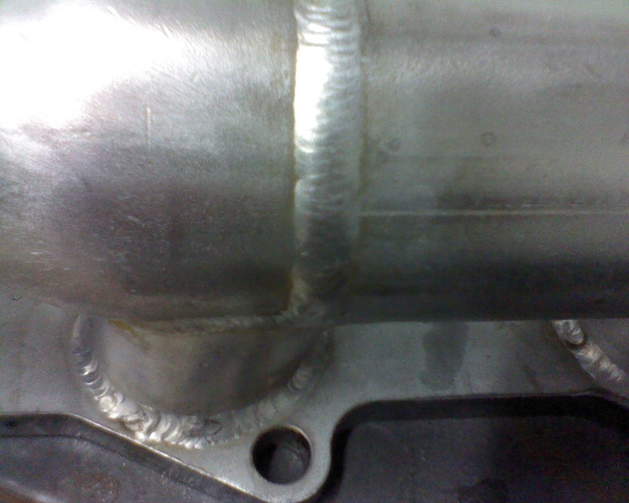

I got a bunch of pieces fit and tacked together in my shop!! Someone's keyboard is gonna get sticky!!! Now, purge, weld, surface, box, ship, done

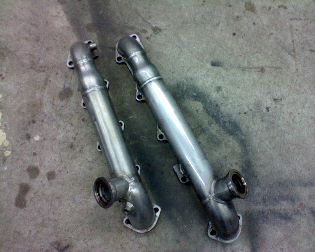

Here are some pics of the second set that I'm making. More to follow.

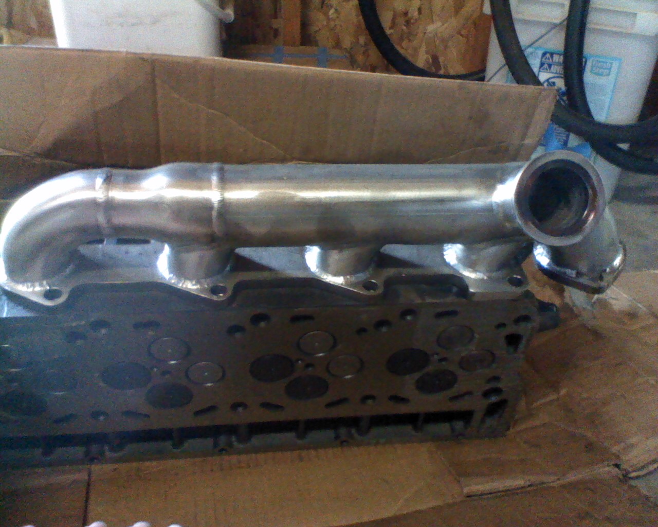

And there's the other side. Going to get surfaced tomorrow, then shipped to Rykan.
