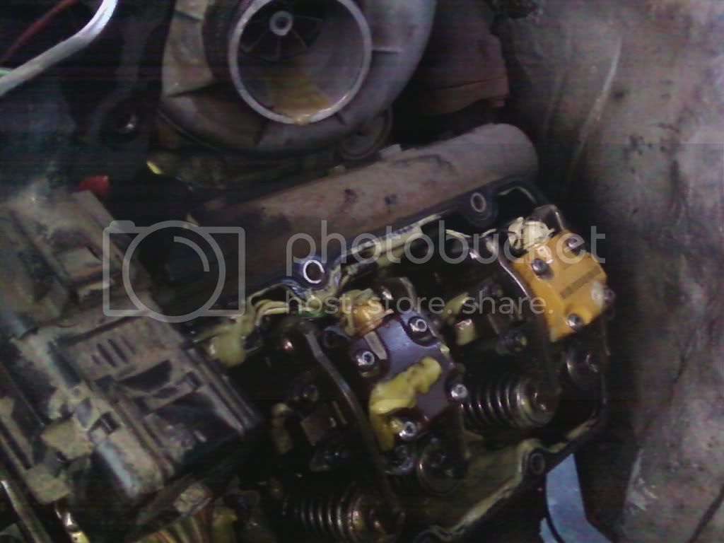

yzmatt
Feb 8, 2013
77
Helix, Or.
There was a nice goo on the valve covers this time and thats all I can figure. Oil looks good and the rest of the head looks good as well. Just a sludgy goo on the valve covers. Figured it happened when I blew out the antifreeze from the gp hole last time and didn't remove it good enough.
yzmatt
Feb 8, 2013
77
Helix, Or.
LOL Holy crap It wasn't even close to that. That would scare the hell out of me. I'm taking pics from now on.
DEEZUZ
NO PUKESTERS
Jun 30, 2011
6,995
256
NWI
yea that was not from doing cups.. didnt find out exactly the cause, customer scrapped the truck i think..
