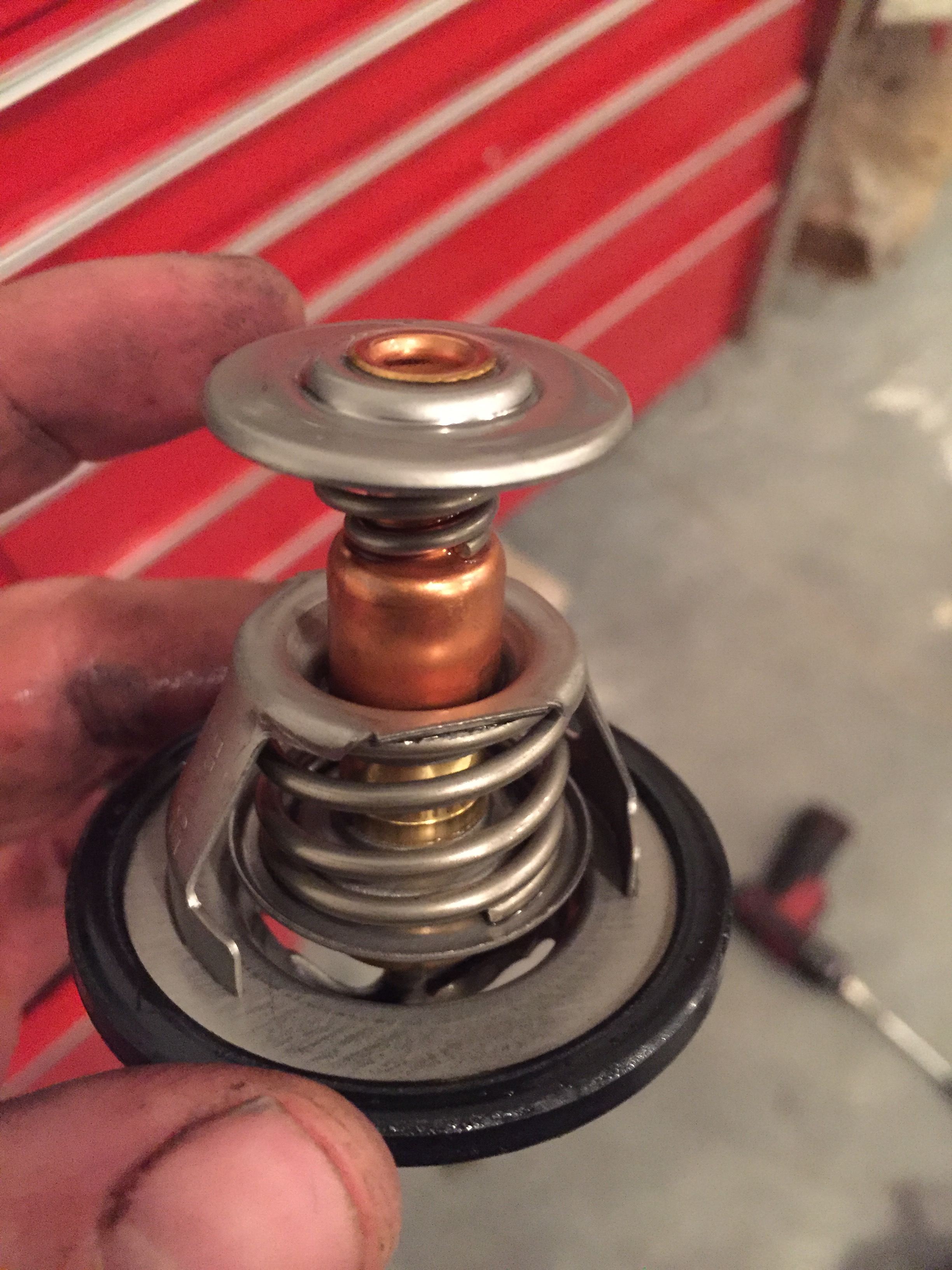

I bet 1.25 gallons is all I put back in last night after draining. and when I pulled the thermostat I only got a splash of coolant out not another gallon or anything so I know the system was empty.
I attached the original picture of the thermostat I pulled and the gap is huge so I am sure it was stuck open. the new one I had didn't seal against the base tight but there was not much of a gap so maybe I will see a difference with this new thermostat.
The thing that has me thinking that the system doesn't have enough capacity is when I pull long his 6% for 5 miles the egts slowly creep up. I bet if there was more fluid in the system to absorb the heat that wouldn't happen. Ill let you guys know how it does this weekend.

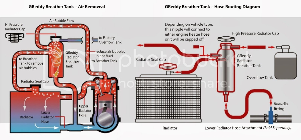

I've built and raced a number of Nissan Z cars over the past 15 years. We use a coolant breather system to remedy these problems with a lot of success.
https://conceptzperformance.com/gre...type-n-fits-most-japanese-vehicles_p_8682.php
