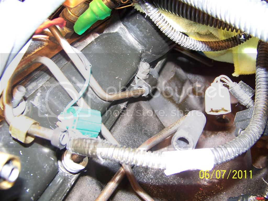

there is a 1\8 " line on right head that runs from the back fwd it sometime gets rubbed through from the clamp
X's 2 this sounds like the likeliest of issues.
Look down in the valley passenger's side near the pedestal, the fuel line is clamped to the intake plenum and will wear through.

If it's smoking I think its the passenger line, either a hole from the clip or the rear fitting. Either way I am guessing its hitting the turbo and smoking.

If it is that line, good temp fix:
1. Cut the line in two at the hole.
2. Get a piece of 1/4" fuel line and two clamps.
3. Put the hose and clamps over the line. Leave the hold down clamp off.
When you get home and have time, you can either replace the hose or put a 1/4" compression clamp from Home Depot in place of the rubber hose. If you use the compression clamp, make sure you also use yellow teflon tape.
