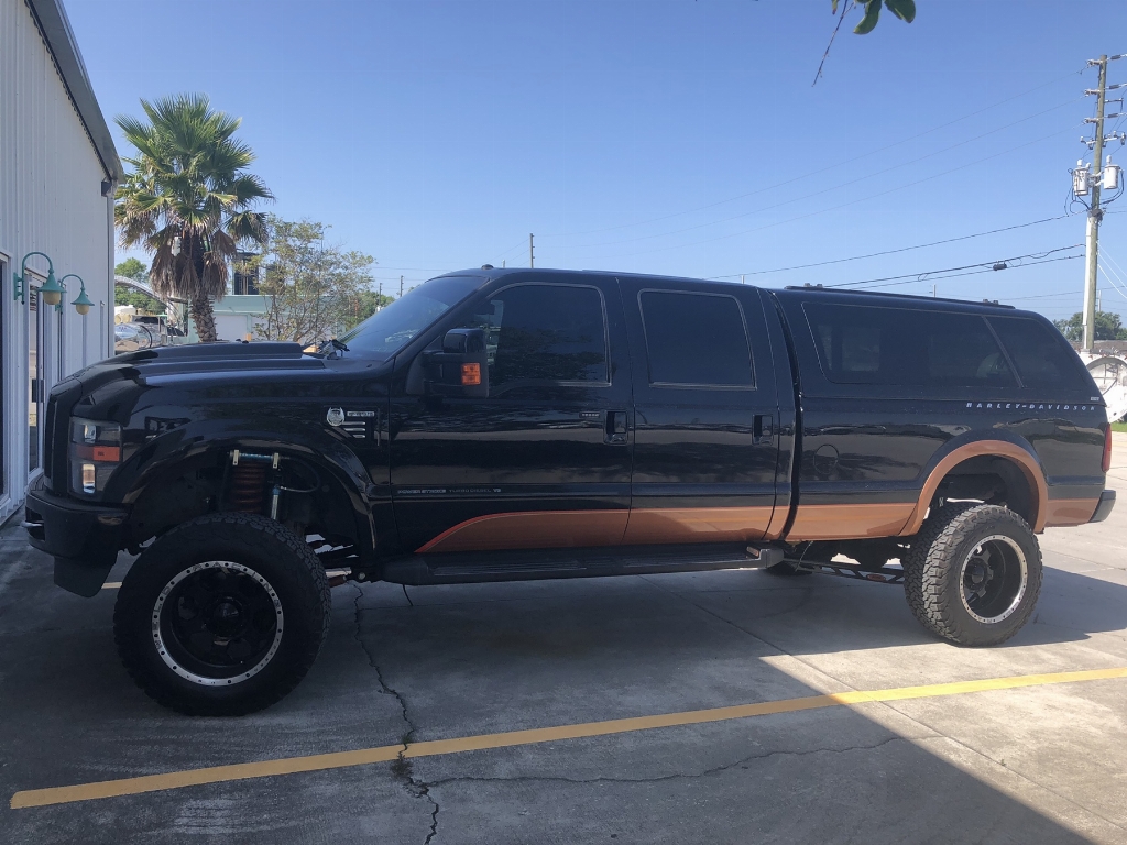

I had some clearance issues at full lock when turning so I had Trevor build me a set of 2” blocks with a 2.5° taper to correct the pinion angle. After adding the 2” blocks I was able to raise the front an inch so good thing I have OUO adjustable coil levelers.

That thing looks like a HD excursion almost lol
Looks good dude!
Thanks. Once my Trail Ready rear bumper shows up I think I'm going to call it good and leave it alone except maybe a lp turbo swap since I might have someone local interested in my 8285 so I might pick up a gen 2 8685.

Loving the setup. 35s?
Pretty much. They are 325/60r20’s so they are little taller than a traditional 35” tire. With these tires and 12” wide wheels with a -51 offset it was all I could do to make them work on the front. It makes me wonder how people were/are running 37’s with 12” wides on a 4.5” lift.
