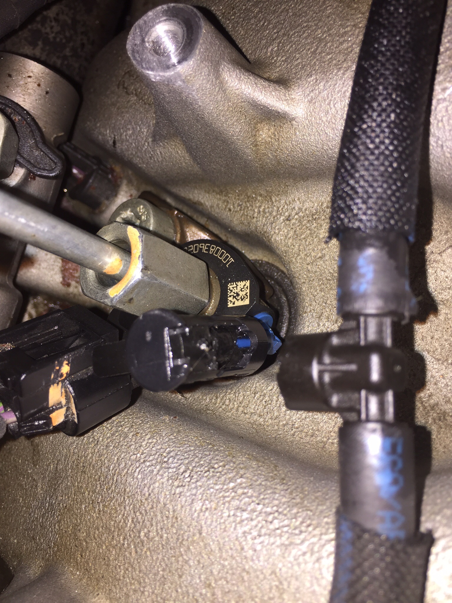

Just gonna toss this out there since it's somewhat similar... I was on a vacation trip from TX to IL running the GH race tune to see what fuel mileage was like since I daily the hot street here in Houston. Anyways on the way back to TX I got on it from a roll pretty hard and lost power and truck wouldnt rev or accelerate so I pulled over. Truck was still running but still wouldn't really rev in park. Turned it off and waited a few mins and turned it back on.. seemed alright till I put it in drive and started to accelerate to pull back on the road. Turned it off and got out and immediately smelled fuel. Popped the hood and looked around and saw it dripping from passenger side.. it turned out to be that one of the caps on the return line popped off and was leaking. Pressed it back on and gave it a little tug and it seemed alright.. this happened back in August and it's been fine ever since.

Guessing that's for me? No not at the fuel filter.. I'm talking about the return line on each injector.. plastic push pins lock the caps on. Looks like the picture attached I found on Google.. in the picture it's broken but that's what it looks like and where's it located.
