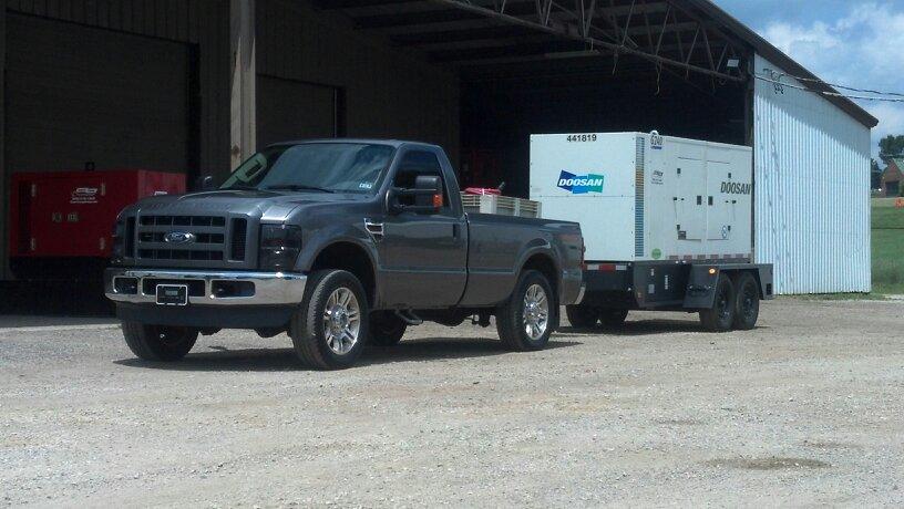

We didnt have time to go to the drag strip today. But instead got to do something way more productive with our time . For all u towing guys that want to make power and not leave any thing behind from making this kind of switch... This might not look big or heavy but the generator unit alone is 12,000lbs and all the cable in the bin in the bed is about 1,700lbs ... egt's were 1015* at about 3/4-7/8 throttle and man does it sound a little different ;) .
Again thank you guys for being as excited as I am :jammin:
We did a similar test with my high powers. Couldn't break 1200 with 10k up a 7% grade at 8000ft. Test was done at wot from 50-75.
