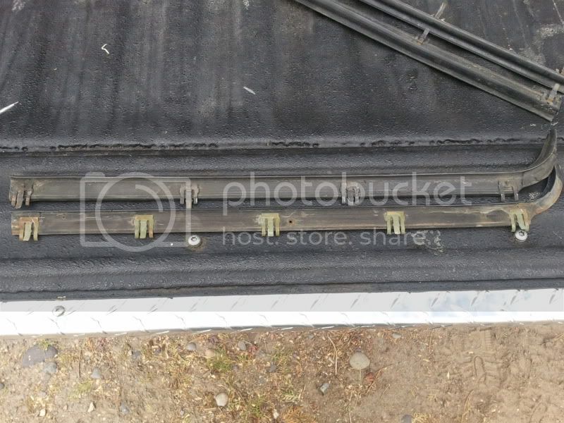

Idaho
I was told that the inner and outer are the same, and they are except that the outer has 5 clips and the inner only has 4. I had a whole bunch of them I got at the junkyard so I took the clips off some and put them on others. It worked. I have a picture somewhere if your interested.
