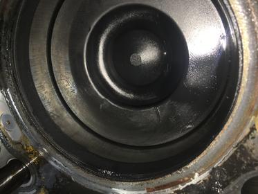

i took apart the motor last night to find #4 and #6 piston decks with valve prints, a bent pushrod, and a potentially bent intake valve. Cylinder walls are great thankfully.

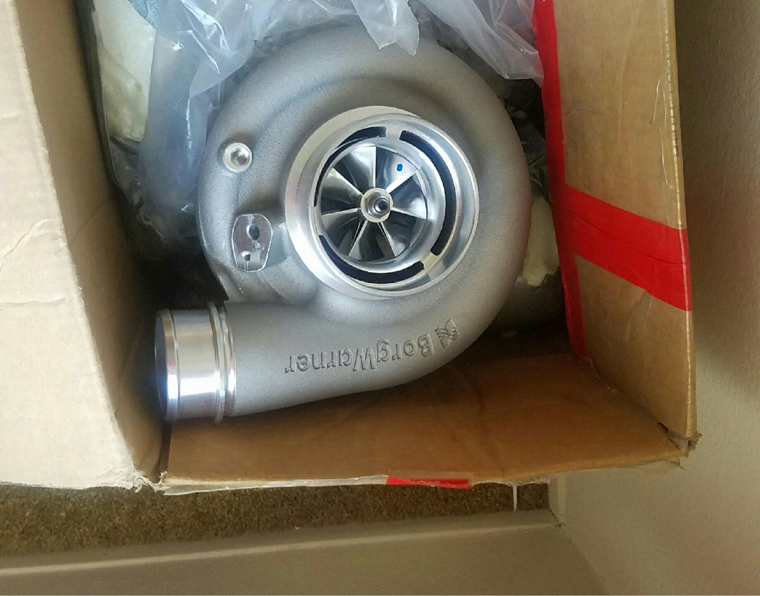

-S369SXE (in hand)

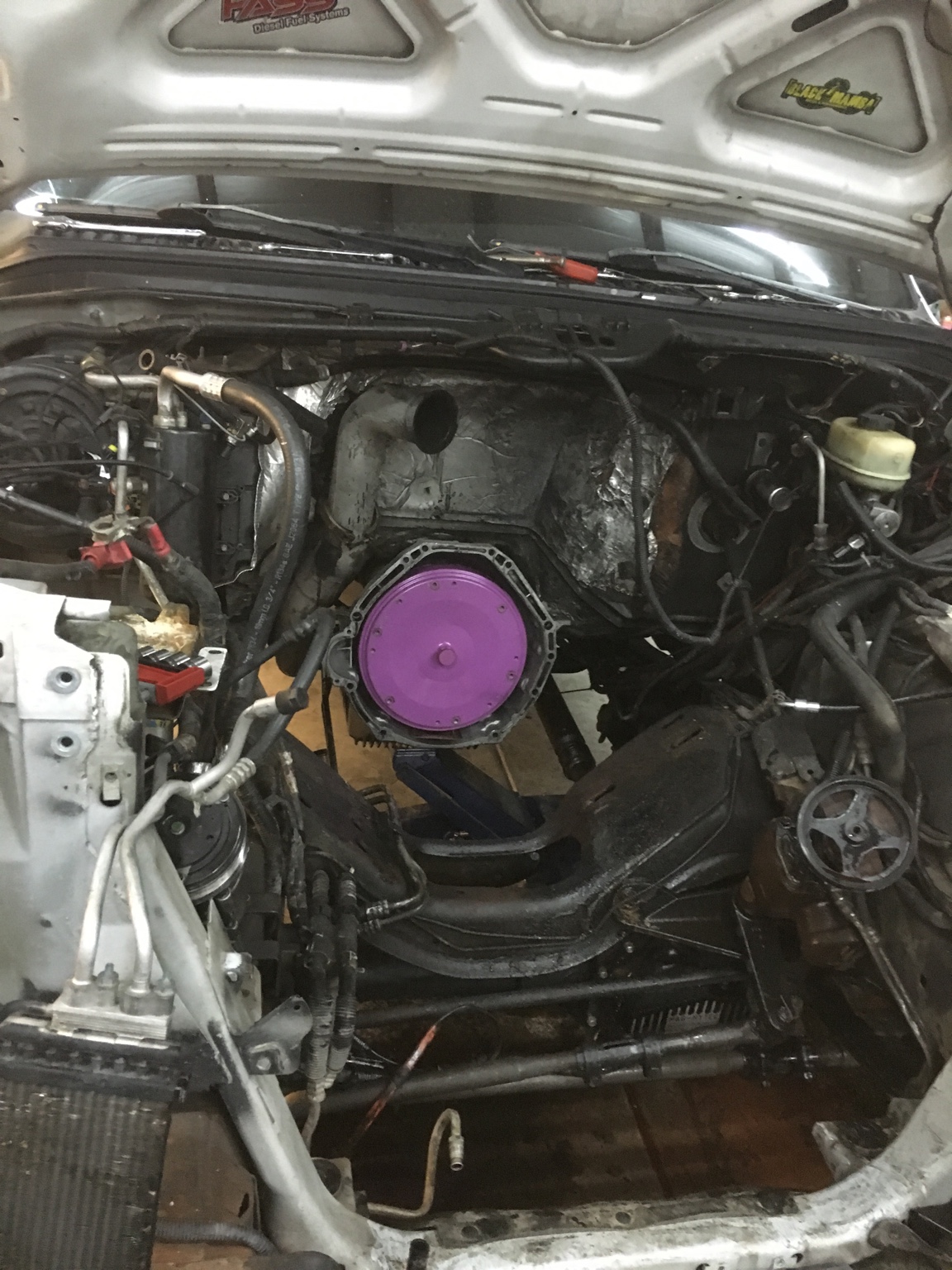

Here are some pics of the truck and the progress so far
