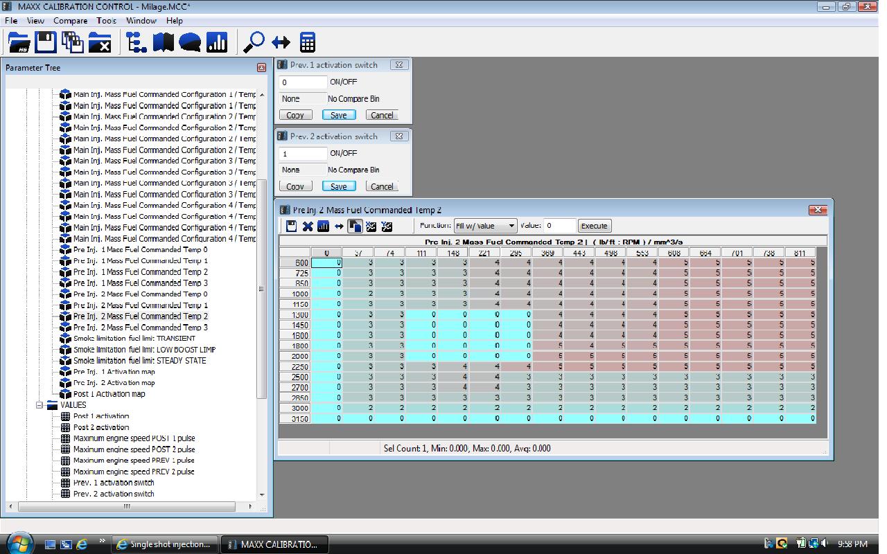

Ok so i might as well post an update. I made a tune with what I would call partial single shot injection. And it seemed to work well.

I would like to see the milage differance between the two tunes but i dont really drive in an area that i can get a good idea of mileage. So i guess when i can get a good read on what the differances are i will let you guys know. But power wasn't down that I could tell smoke wasn't bad and the noise wasnt bad either. I really think it would make decent mileage on the highway if anybody wants to try it.

I'm kind of attempting to ease my way into removing the pilot injection to a point. My thoughts were to keep the second pilot event to keep noise down while still "preheating" the cylinder for the main event. Then I removed the second event at the highway speeds to save as much fuel as possible. This way you would already have boost built up so smoke wont be much of an issue if at all. Plus at highway speed you really dont notice the noise differance. I would really like to try this tune out on the highway soon! I think it will do well. I did try it around where I live but I'm pretty much in the sticks so I didn't get much time at a steady highway speed.

Haven't been on the highway yet either but all my pre/pilot injections are removed. Only difference ive noticed is its louder, not huei loud but deff louder than stock. Oh and u need to advance ur main injection timing on the 500-725 rpm area to allow the truck to start like normal. Mine took longer to crank and would haze white smoke until I advaned the timing a few degrees.

What do you set the pre injection table to all zeros?

There is 2 preinjection activation menus to either turn it on or off. 1 being on and 0 being off. There is preinjection activation 1 and preinjection activation 2.

ok i just turned off prev. 1 and 2 activeation switch , so how do you advance the timing? and by how much

So far the truck is running fine, wouldn't know I had done anything to it if it wasn't louder. On the timing, I just started advancing it a couple degrees at a time untill it started like normal again. Figured if the pre-injection shot was about 9* BTDC, then working the main from 4* ATDC slowly to about 3*BTDC wouldn't be to big of an issue.

you got a screenshot of the timing tables? and do you do all the config and temp tables to the same values
