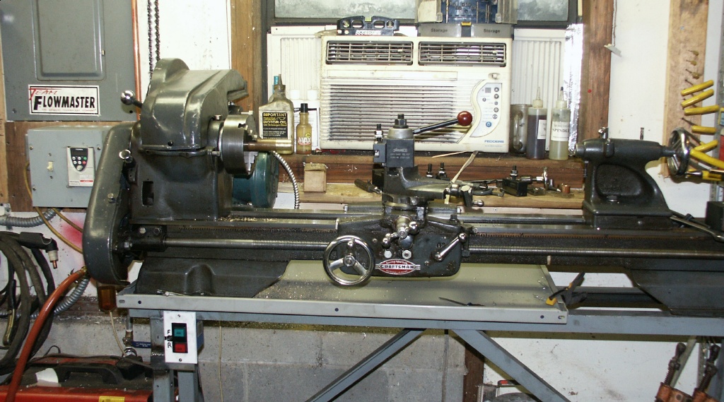

I think we all are ? I couldn't find a nice small usa mill but my lathe is an old craftsman same as below
