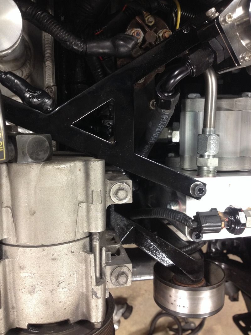

And the quality of the bottle, outstanding. Looks great. Every weld is invisible. Very nicely done. I highly recommend one so far. I'll get more a a review once truck is together and running.

I'd like to see how these look mounted up. Looks like a dang nice product.

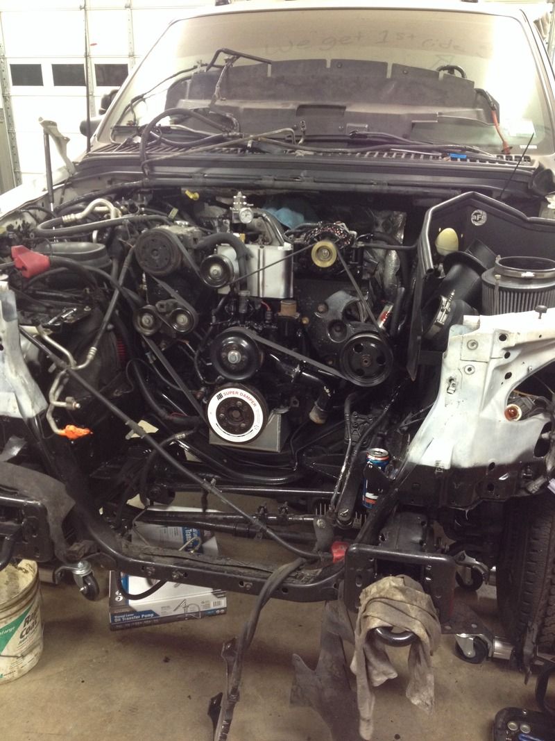

love that pipe color TJ....glad to see you moving ahead with the progress on this
Thanks bud. I was hoping rad and ic show up tomorrow or Thursday to put cab back down and start buttoning it up, but after this storm, I'll be headed down to south jersey and pa for outages. May miss atco Saturday too.

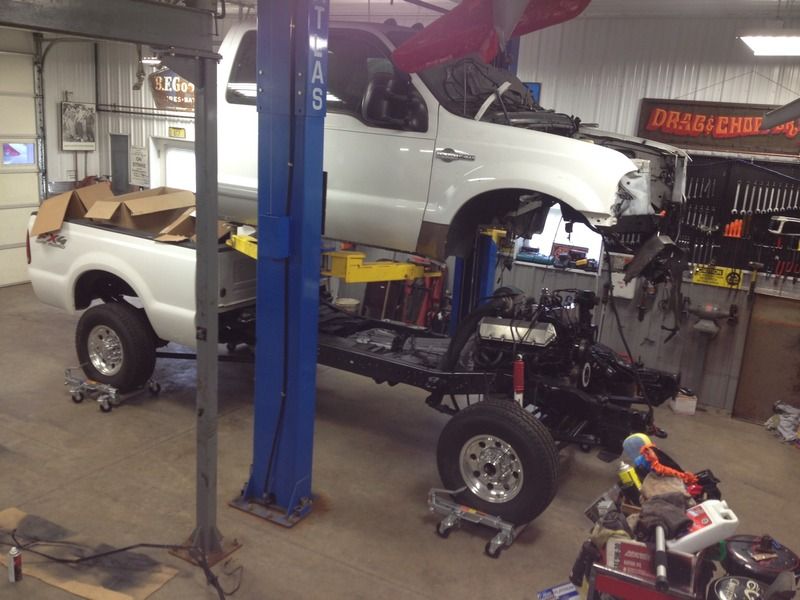

Making some good progress! !
How tall is that shop? I'm in the planning stages and want one just tall enough for a 2 post lift
Sent from my SAMSUNG-SGH-I537 using Tapatalk
gnxtc2
Jun 22, 2011
2,210
5
Bergen County, NJ USA
Building from scratch, 14' is a good starting height.
My shop is 12' and it works for me. With my truck on the lift and raised up, I can't reach but I'm 5'9".
The crossbars for most 2 post lifts are around 144" (12') unless you opt for the higher version. Mohawk lifts don't have crossbars but are $$$$.
Got to keep this in the back of your mind, the higher the ceiling the more area you have to heat and heat rises.
Pics of my shop, 12' ceiling.
When you're ready to buy a lift, 10k mininum and make sure it's certified.

Thanks for the pics
I just want everything tall enough to raise the truck and be able to walk/work underneath it
I'll have to double check, but i think the lifts I was looking at had a height of 13'.xx which is why I wanted a 14' building
