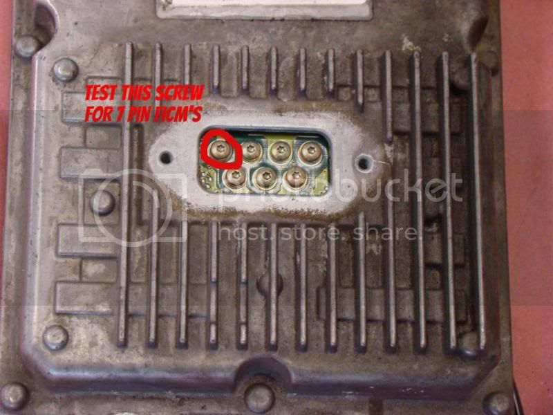

The procedure is the same for FICM’s with 7 screws, except that you will be checking voltage at a different screw, as shown in this picture.
*EDIT*
It's not very clear here, which screw you need to test on the 7 pin units, so I'm adding this in. When you remove the cover, you will see 2 rows of screws. The lower row has 3 screws, the upper row has 4 screws. You want to test at the screw in the row of 4 that is closest to the passenger side fender. Opposite of the 4 pin. I hope this clears this up.
7 screw FICM
If the voltage is above 46 volts in all the tests, your FICM is in excellent condition. If it is between 36 and 45 volts its OK, but not great. If it is between 25 and 35 volts, you have serious FICM problems.

Looks like the links to the pictures they had for the 4 pin and 7 pin are busted, I'll see if I can dig mine up.
Ok, added some mark ups to make this stupid easy for you.
4 Pin FICM:
7 pin FICM:
Again, thanks to SWAMPS as most of this was copied from them. I added the part about testing the 7 pins as it wasn't clear. Hope that's cool...

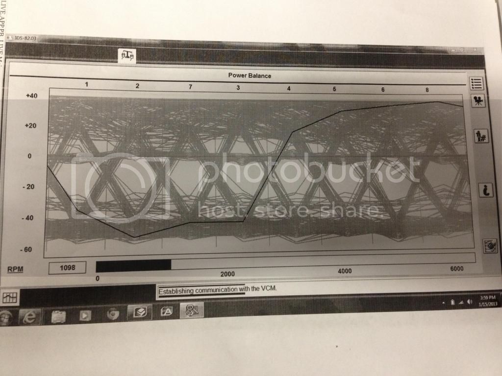

You know I was just talking to Josh about this last night. When I first installed my 175/stock injectors, I had a really bad miss when the temp was below 30*. So many people thought I was crazy. Swore it couldn't be. This is what the truck sounded like:
http://www.youtube.com/watch?v=rIwQlOd0MI0
Took it to the dealer and had a power balance done on it. This was the result of what you heard in the video:
So I had a FICM overnighted thinking that was the issue. Nope. Finally emailed the video and the graph to Matt. He pulled fuel from my tunes at idle and haven't had that happen again. Myself and a couple others think it may have had something to do with plugged spill ports in the injectors.
Now, my truck use to idle slightly rough when it was cold and all stock but nowhere near anything like this. I figured this was a good place to chime in about that although it may not help anyone and may not even make sense to some.
