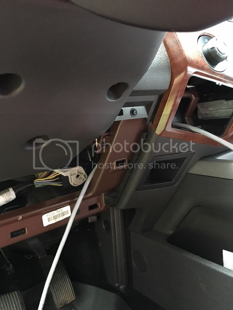

*Use a small flathead or something similar to get behind the plastic. Apply a little pressure and the clips will release.

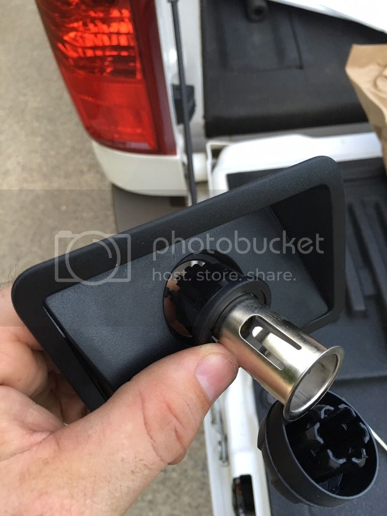

*Pull the two clips on the side of the 12V outlet and pull the plug out the front.

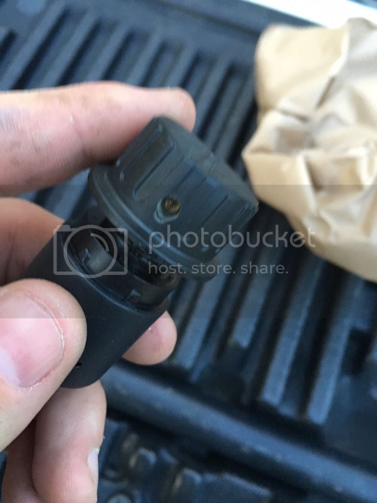

*Loosen the set screw on the knob to remove it.

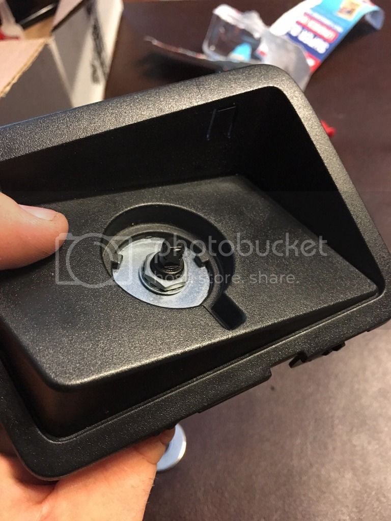

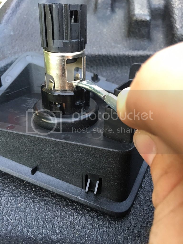

*I used a 3/8" fender washer. The pic shows it on the back side, but I felt putting it on the front side allowed the set screw on the knob to engage better. That is what I ended up doing. I glued the washer to the plastic as I didn't want the whole assembly to have the chance to rotate. If you do, make sure the hole is in the center or the knob will rub the side of the hole and be hard to turn. 1/2" wrench or socket to tighten jam nut.

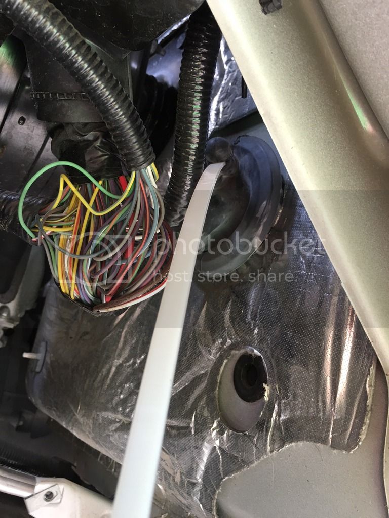

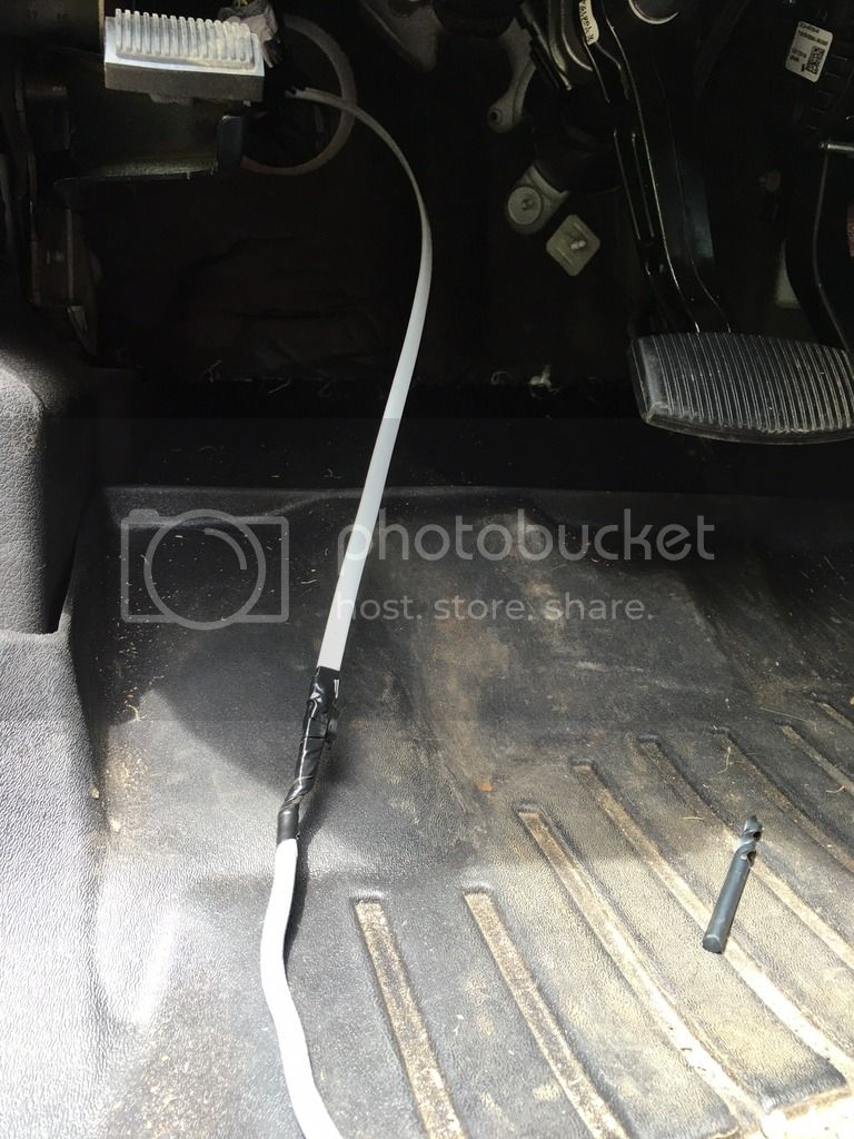

*All that's left now is to pull the wire through the big rubber grommet in the firewall under the dash and plug it in to the CAC air temp sensor. I used a large zip tie as a fish tape to pull the wire through. I also removed the fender liner for pics. It made the routing of the wire really easy, but it isn't necessary.
