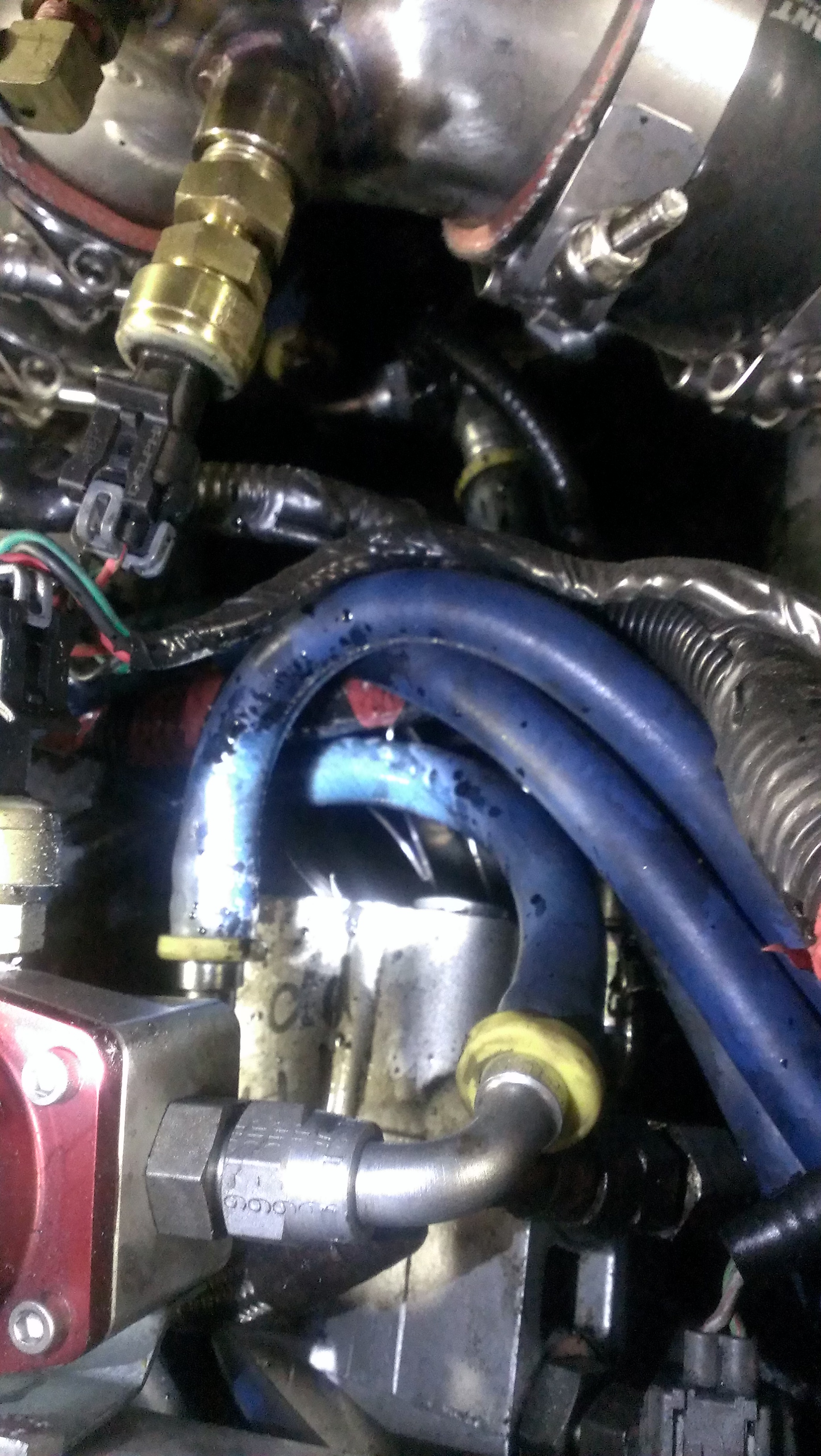

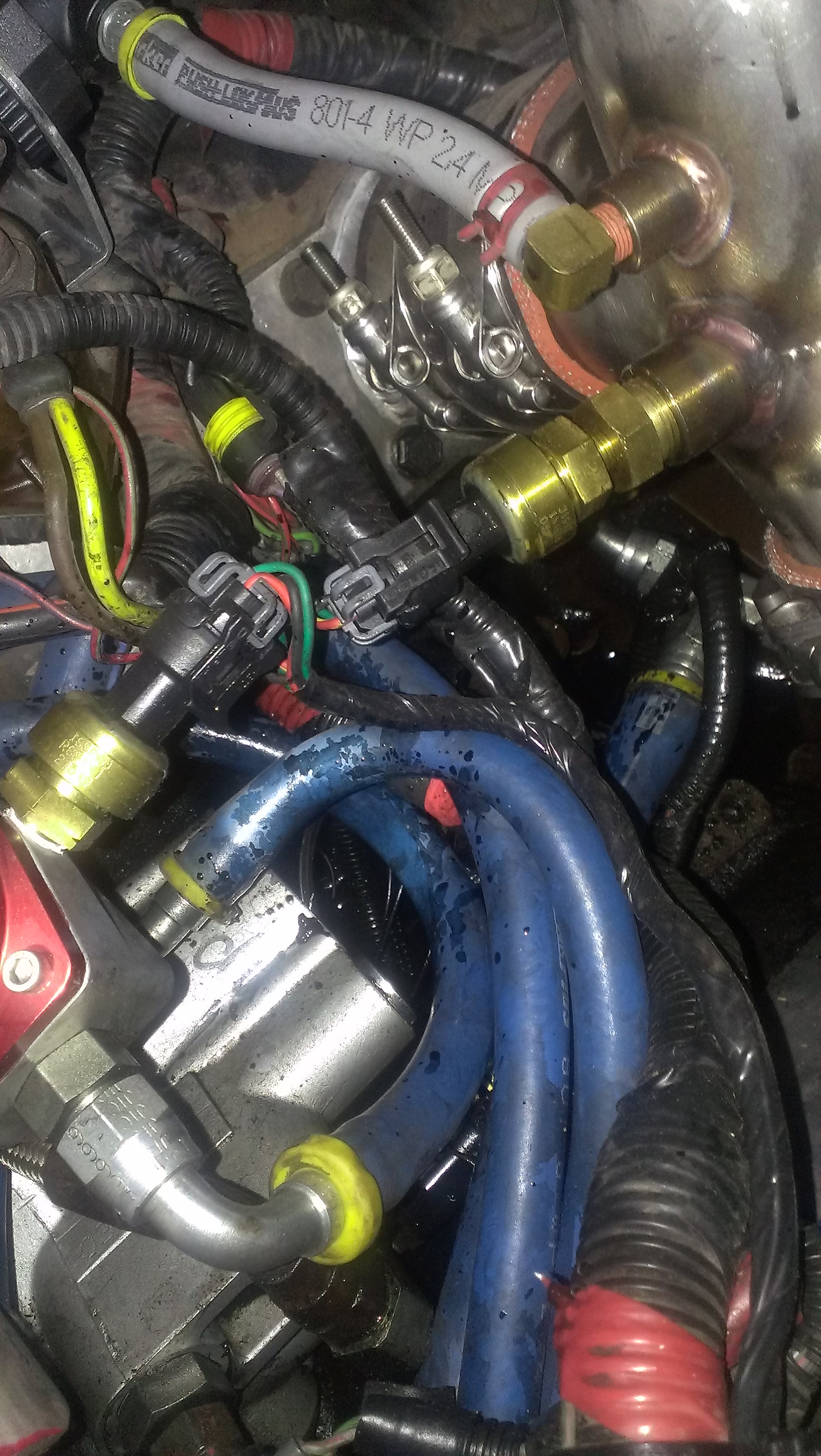

Txted Marty there is rigns protruding from the back side of the pump letting oil fly everywhere. Ill get pics up tomorrow. I have has it for about 15000 miles bought brand new. No idea what caused it

these are the best i could get. you can see the metal rings hanging from the back of the pump

remove pump. Place in press, press plug down into pump, re insert ring. Or send it to Gary and he'll do it! First one i've seen do that.
