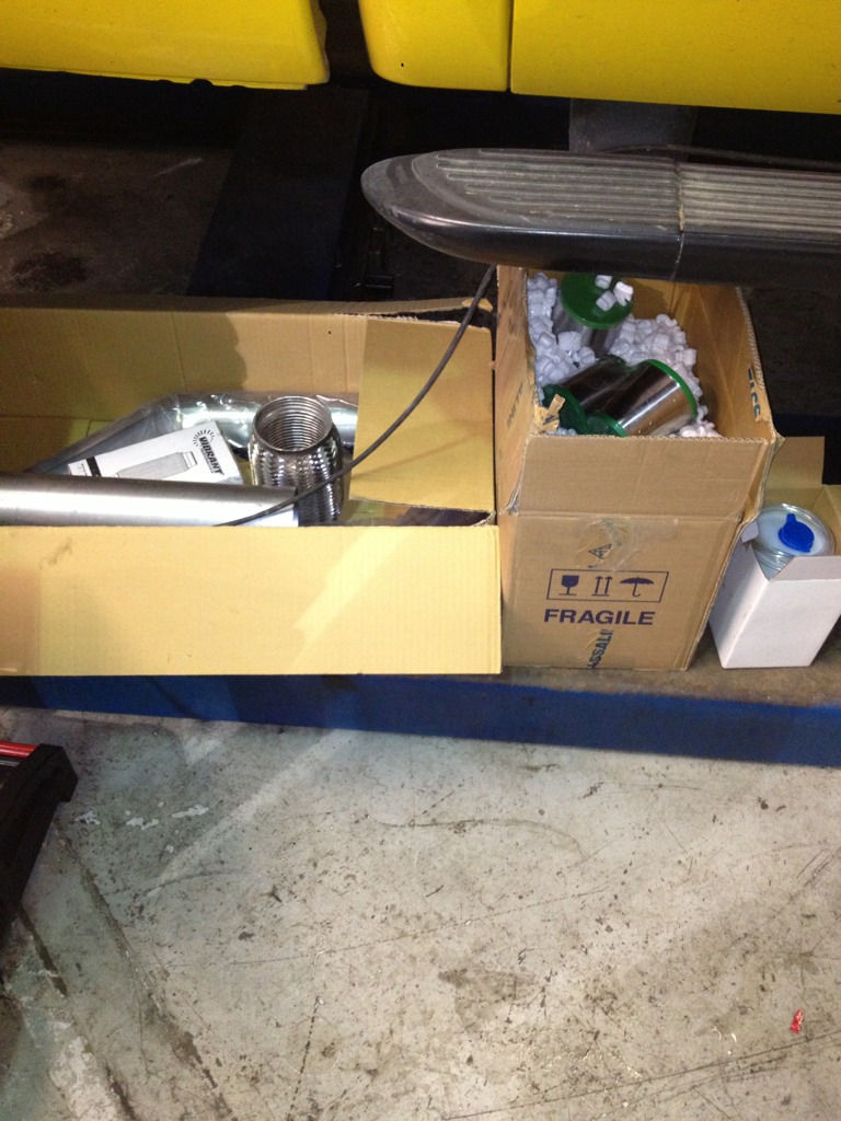

Piping came in last week also got a smaller washer res to free up some more room. I should have pics of the battery tray today and some fancy heat shields to protect the wiring. Other updates oil filter relocate is done have it sitting on the drivers side inside frame rail. Hopefully this thing is done by the end of the month been 5 months without my truck looking forward to driving it again.
