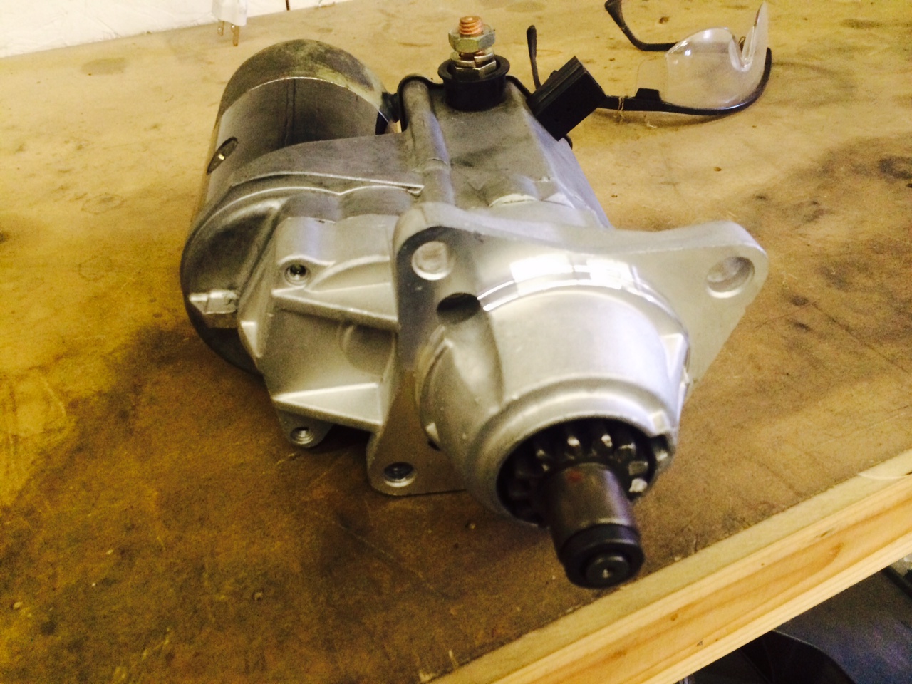

check out the 16658. its 3 bolt for the PSD and I got it to replace the motor on the dragbike starter.
Enoch
272
What brand is 16658?
Mine is a 3 bolt Mitsubishi with 12 teeth, the Nippendenso I looked at today that they said is for the F250 but 2 bolt style is 13 teeth and shaft was different size and really didn't seem like it would come close to mounting up.
mandkole
Jan 14, 2012
2,303
Northwest
a couple pics... the nose is actually still brand new (from the 16658) but I loosely bolted it up to the old motor thats worn out. The 2 bolt nose is still being used as the dragbike starter, but it gives you an idea.
Its a standard part number thats available from multiple brands. Romaine sells them as brand new.
