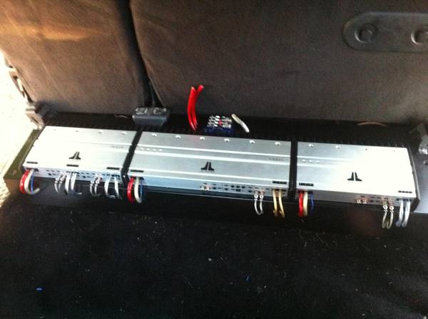

Ok. Posting for my boy Rico. Internet out at his house.
Amps pretty much done:
UNBROKEN
2,788
I gotta pull wires and shrink wrap the ends, bolt down the amps and rack then clean it all up. It's coming together though.
UNBROKEN
2,788
Streetwires ZN6 rca's and 8 gauge speaker wire for the sub.
I heart overkill. LOL

Weekend updates:
Got the new carpet in and seats reupholstered....had to get the back seat in to mount the amp rack.
Here it is wired up but not muunted or amps screwed down yet.

Irontx
843
Texas
Thats rockin right on along man. Looks real nice.
One question, hows the heat with those amps sandwiched in between the back seat like that??
