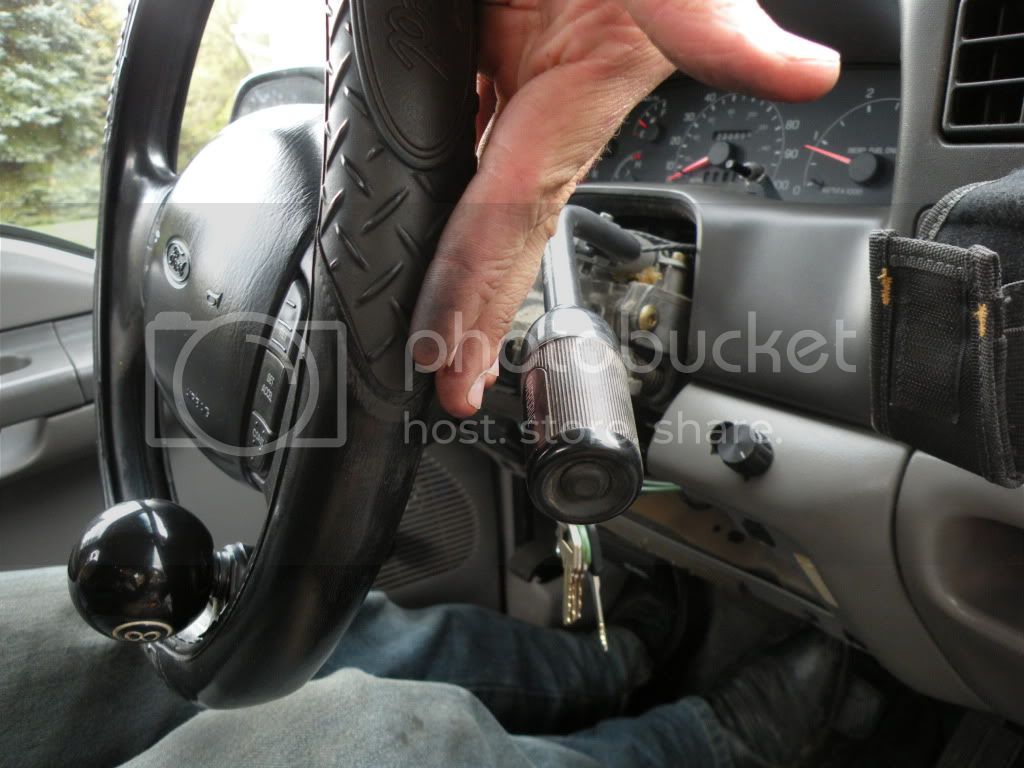

Looking underneith there is alittle ball that needs to be pressed in to release the key fob, it will only release with your key in that unlocked position-
Get something like a allen wrench, pick, punch, ext to push that ball in-
Push that ball in-
Now gently pull outward on the key fob while turning it foward slightly- (gently is the word)
At this point you will have to turn it foward to the "ON" position & your glowplugs (& what else have you) will come on, at this point it should slide out, if not try turning it backwards or fowards a HAIR-

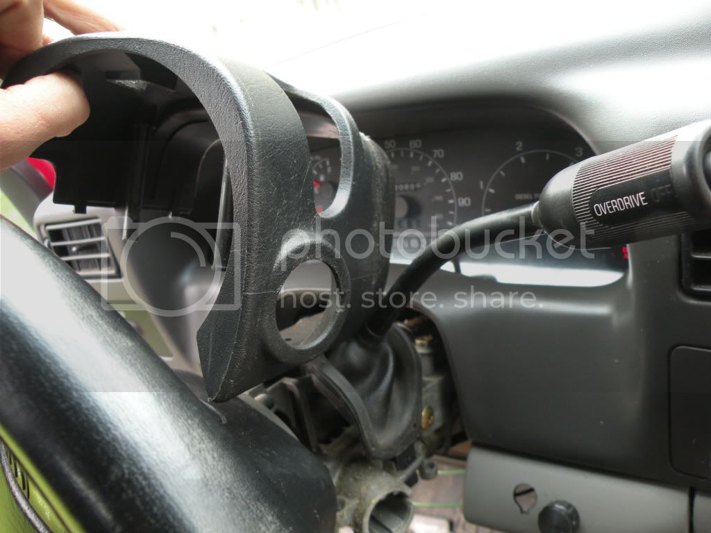

Now just wiggle the top peice until it comes off-

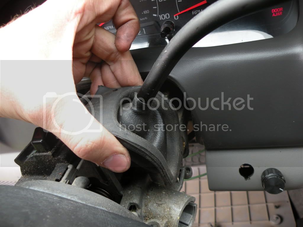

Pull up & remove the rubber boot-
Pull it out of the way, you can re-use it on your new arm-

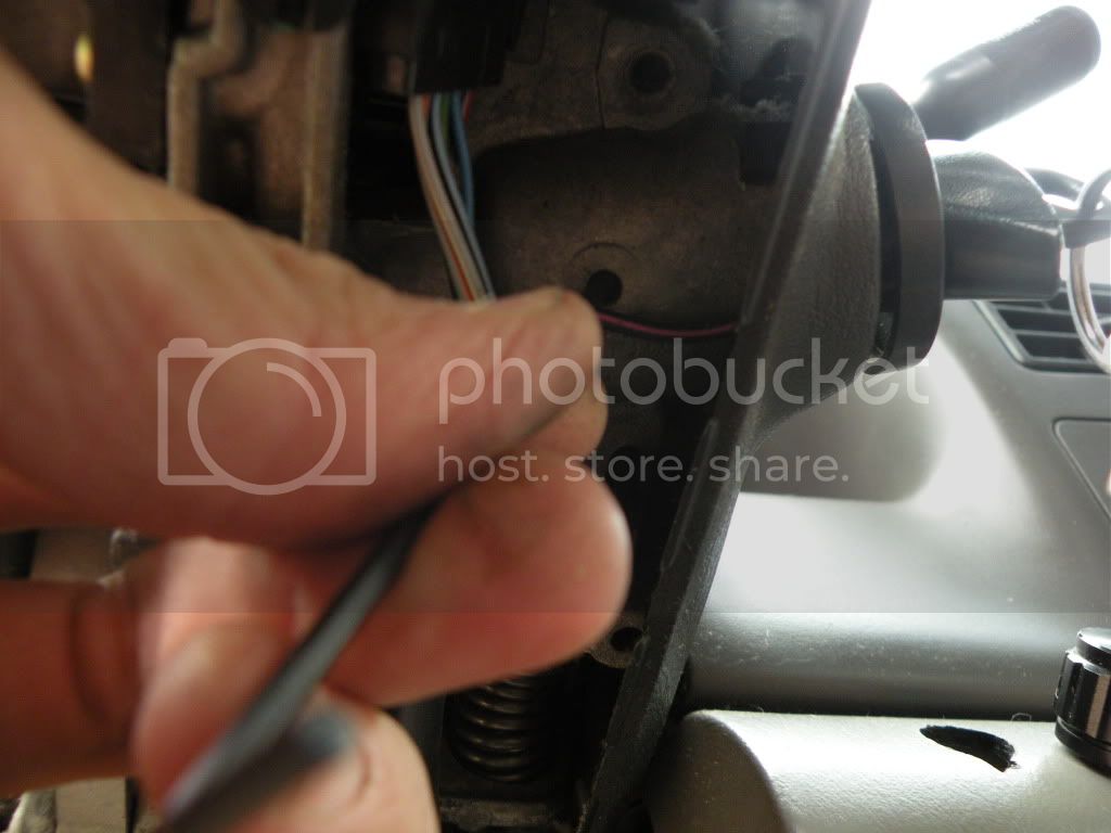

Next part can be a pain, if you have large hands you might need a small screw driver. You need to pry the locking tab for the wiring connector downward while pulling on the plug, remember be gentle with it-
Got it off-

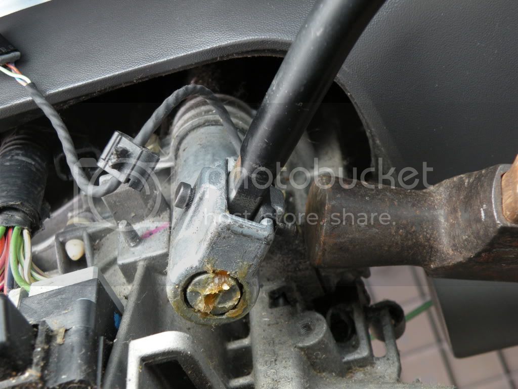

Next step is to remove the arm, it's held in by a pin that just needs a few light taps with a hammer to remove-
& it's out-

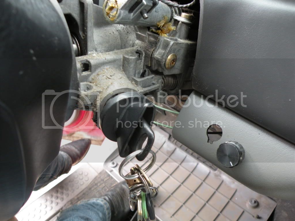

Line up the fob with the slots & gently insert it, you will have to turn it back & forth SLIGHTLY (not much at all) to get it installed properly.
Should look like this when it's properly installed-
Double check & see if the ball went back into it's hole on the underside-
Once you confirm that the ball is installed you can turn the key foward to make sure it seats & start the truck if you desire.
