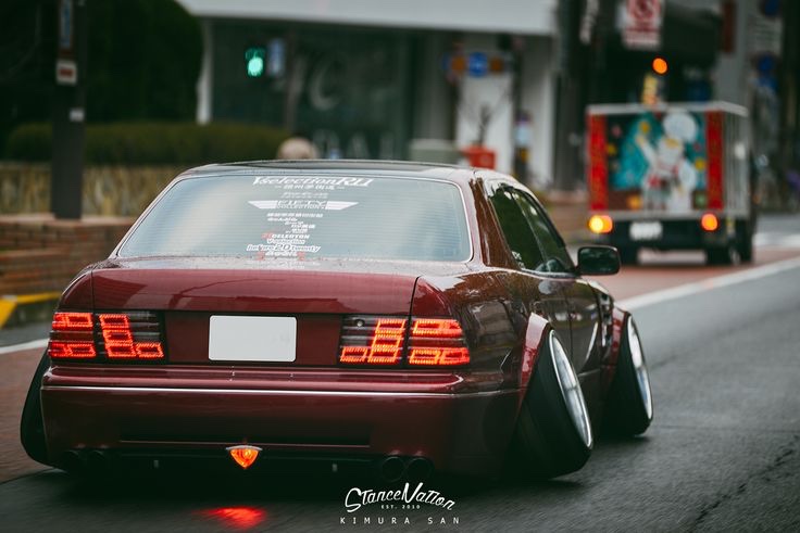

So I would appreciate it if I come in here asking to run 14" wide wheels and spacers(I know that is not what the OP asked). I would fully expect people to give me an honest opinion that not only does it look like a bag of dicks. But it blows out your wheel bearings, takes out ball joints, drives like garbage, dangerous to drive, is illegal in most states, requires you to do some MAJOR trimming to turn the wheels, and I am sure there are a lot more negatives then positives.
I don't know if there really is a positive for some of these wheel/tire combos these days......better brake cooling? Since the wheel doesn't surround the brake rotor anymore.
Most of these guys that run these obnoxious wheel/tire combos don't care what you think anyways. It is all about "Stance"....
It's a real time saver when you can do a brake job without removing the wheels.

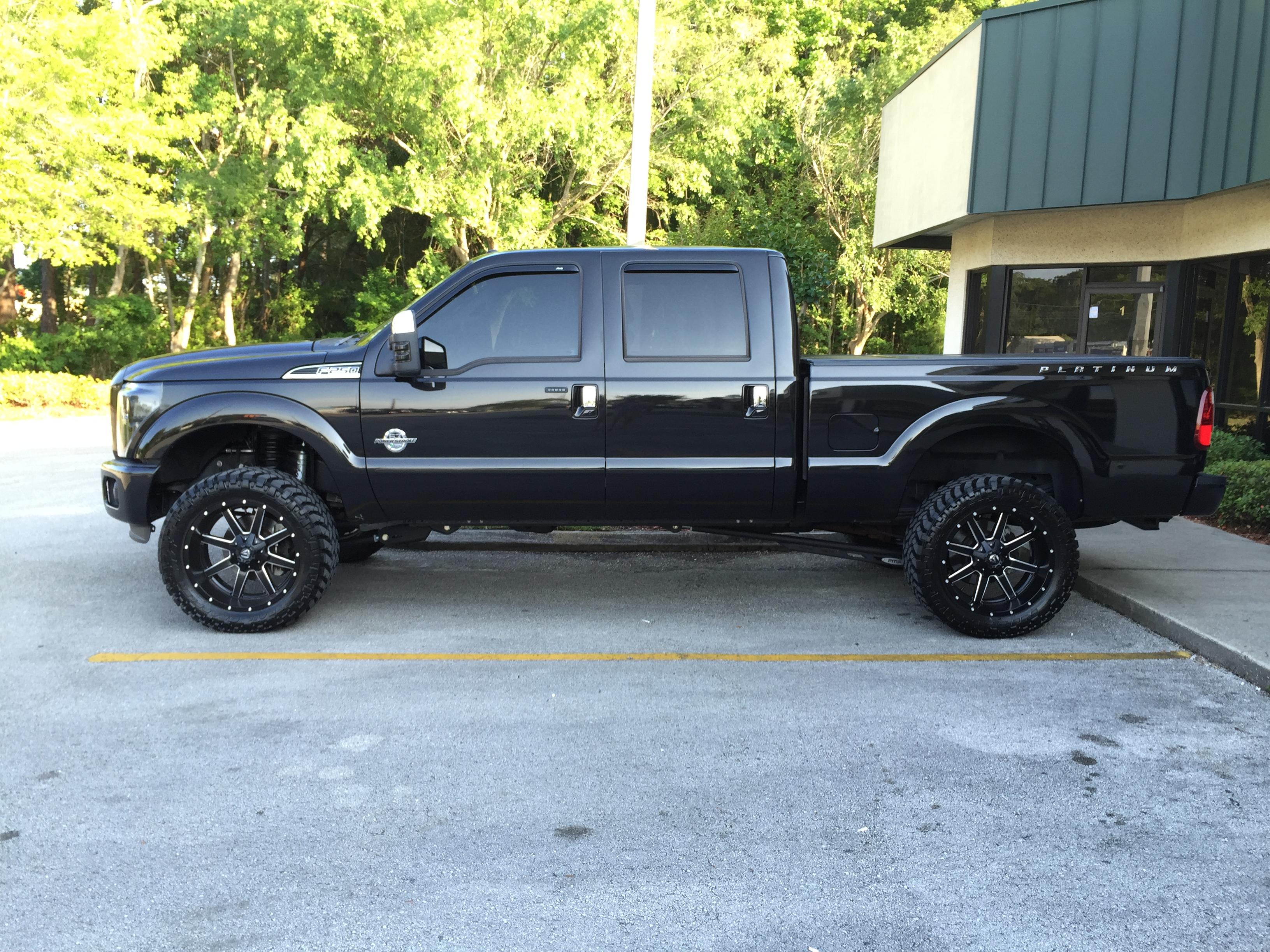

Here is mine with 1.5" in front and stock rear. It sits level, but could use air bags and f350 shackles for when hooked to a trailer. They are 20x10's with 35x12.50 Toyo AT2's. This required pulling back and trimming the fender liners and trimming the bottom edge of the fender. It still runs slightly at full lock, but o didn't want to go any taller.

It looks good!

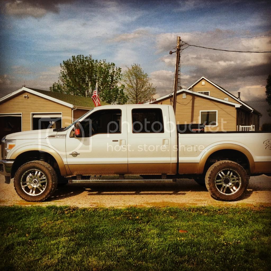

Here is mine before the 1.5" leveling kit. I was running 20x10 with 35-12.50 Toyo mt with a -24 offset. I rubbed at full lock. Just trimmed the inner fender well and some of the plastic flare.

it looks an inch high in the rear, maybe it's camera angle though .

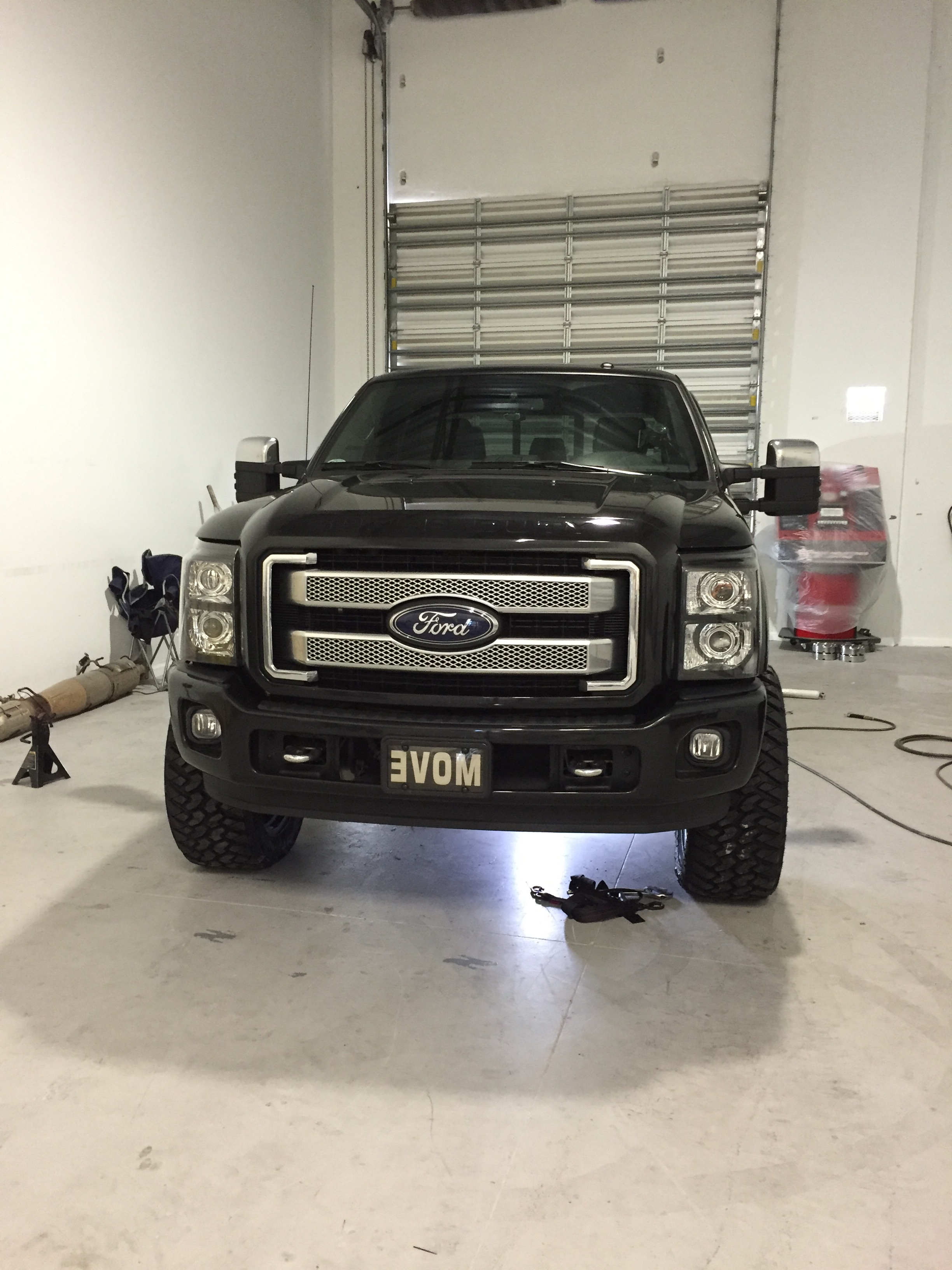

Here are a couple of pictures with 20x10's -25 offset. Tires are a 35x13.50 mickey tompson ATZ's. It as Icon 2.5" coils on it and a 5" rear block as I like a little rake because I do tow a lot, so I don't want to air up the bags every time a little trailer gets hooked to it. It did take some trimming of the inner fenders to clear this, nothing I couldn't get done with a dremmel tool.
How far they stick out
I also have pictures of the truck how it sits now at 3.5" with 20x12's and the same tires. If you want to see those let me know
The exact look I want!!!!
