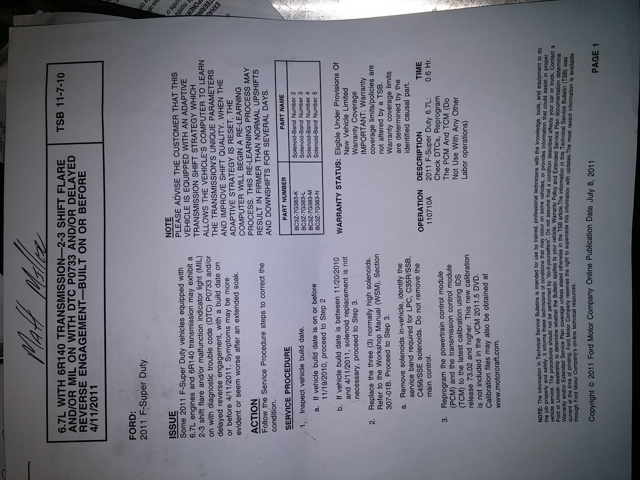

They are the Ford solenoids to do the TSB on the early 11 trucks.

Interestingly enough, the 2011 were not the only ones plagued with a shift flare.
The #5,7,10 solenoids need replaced.
I personally have not done this to mine. But from the reports I've read it seems the be the magic ticket to shift flaring and hard shift specifically on 2-3 flare and 4-5 harsh.

I also have a 2011, but not early build. Do you have the part numbers for these solenoids and the TSB that relates to this? I always related my occasional random shift flares to the H&S tuning as it never did it stock.

I've got all the stuff at home and will post up once I get back. Out working in Western IA this week. I ended up just buying all the solenoids as the price my guy shot me just made it easy. The question will be if it will move once I swap them. The TSB references a TCM programming update as I think some solenoids may go from NO to NC or vice versa. Not 100% sure though.

I suppose the solenoids can be looked up on fordparts.com I use the sunrise ford dealer code when referencing prices. As far as the TSB. I found it on thedieselstop.com I do believe. I could probably google it and find it again real fast.

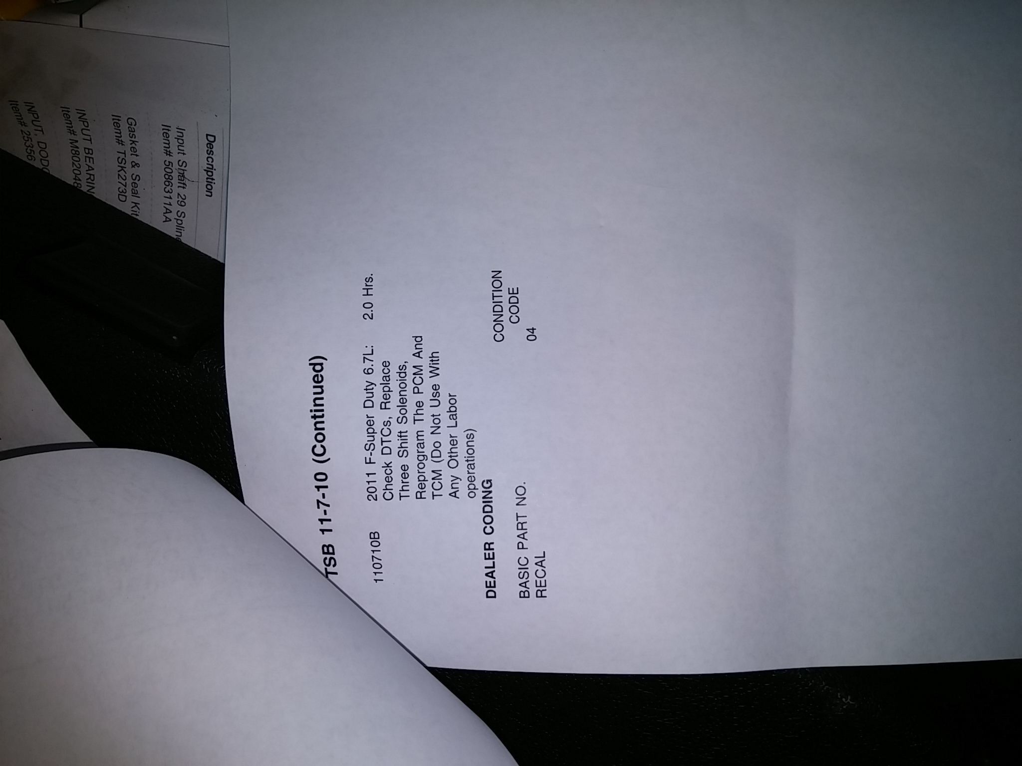

Buck1
Jan 10, 2014
1,166
Winchester, IN
As promised. Price was reasonable on solenoids, so I am doing them all.
