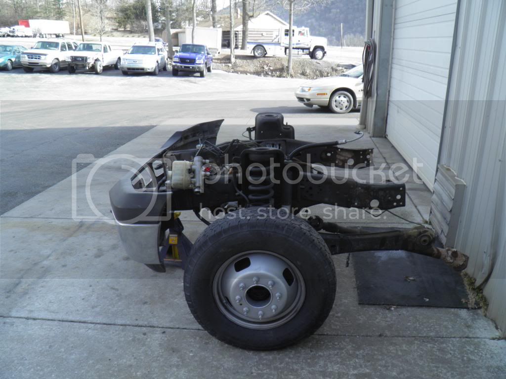

Easy! You can do it exactly like factory. Just need CClb rear section and do it like this
