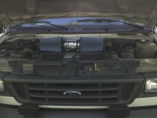

rpm-inc
988
Here was my van intake.
CSIPSD
5,284
5
Bend, OR
I doubt you will need a dual intake for the 200cc injectors... But thats a perfect design.
