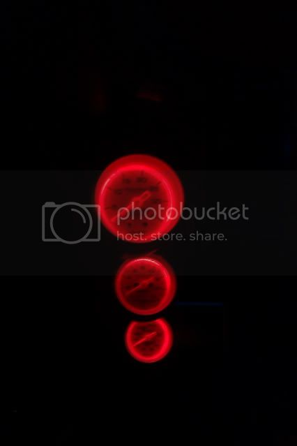

I'd really like to replace all the interior light bulbs and Autometer gauge light bulbs with LED's...
The difference in the gauges above is crazy!

I agree it is a night and day difference LOL I went ahead and ordered the same bulbs for my door panels. I got new dome lights, reverse lights and cargo lights. My truck is going to light up like a Christmas tree

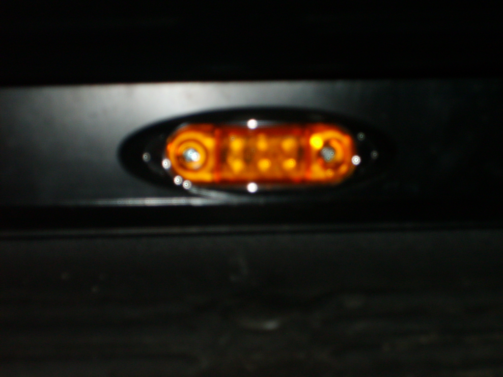

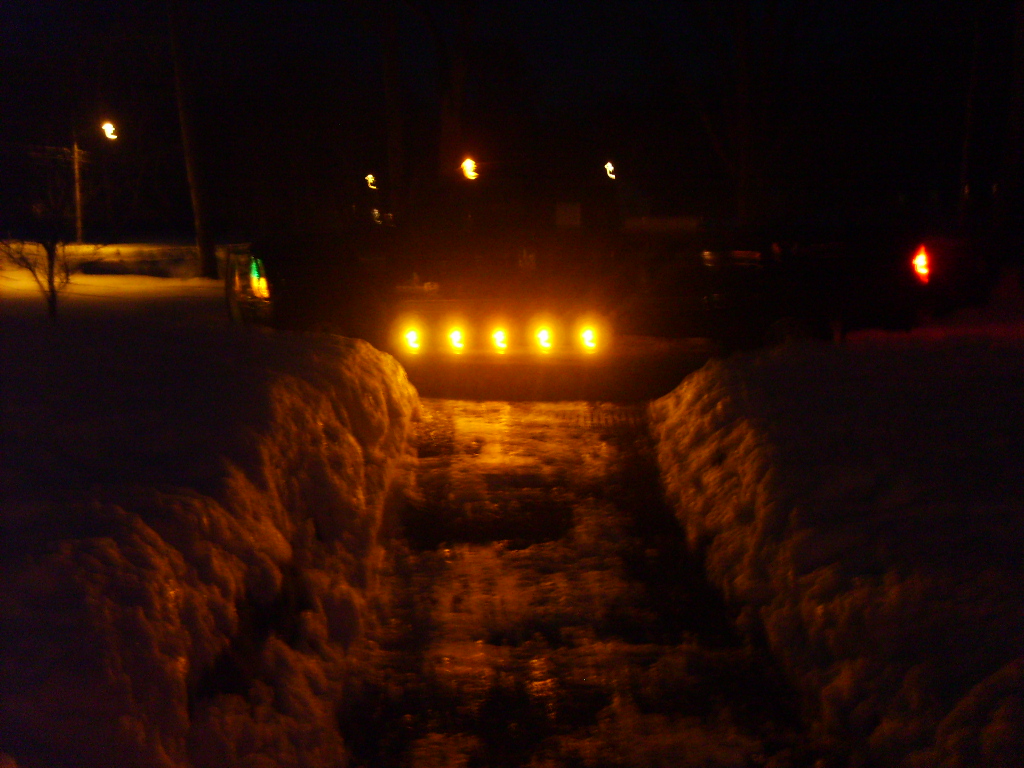

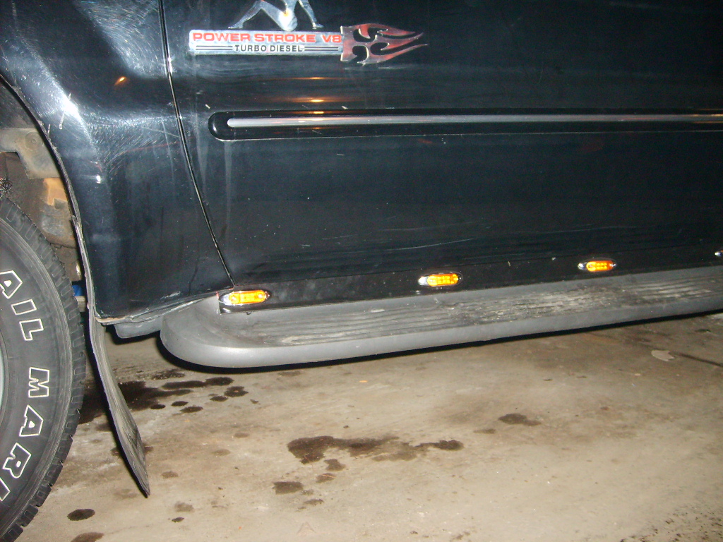

i got mine at a local chrome shop for big trucks..there like what retro has listed.. they fit fine in my autometers.. did you get the 194?? there is another bulb close to the 194 that fits the same socket..but its a longer bulb...i do not remember the part#
i also got 10 running lights for 80 bucks and they have a life time warranty..one burns out..i bring it back and i get a new one...
