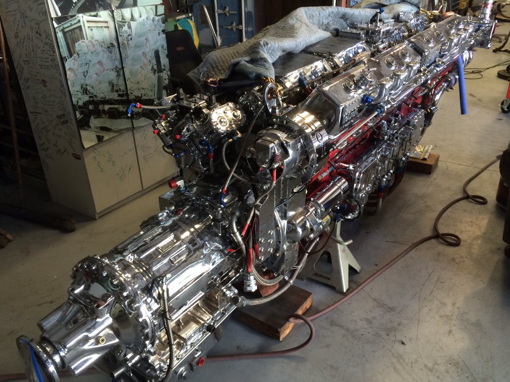

Found a picture of the bank duramax marine engines. Note how the filter is at the blower inlet.

Yea I bet that will fit under the hood!
Gale banks spent 100 grand on that dmax and could have made 800 with compounds and a fuel pump...
