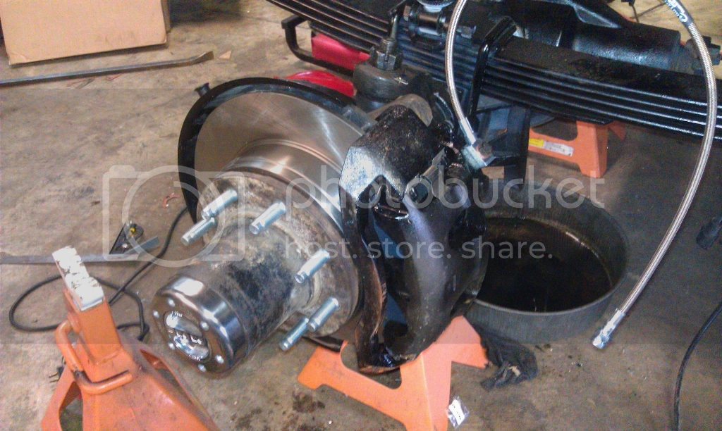

This My 99 fummins Superduty 60

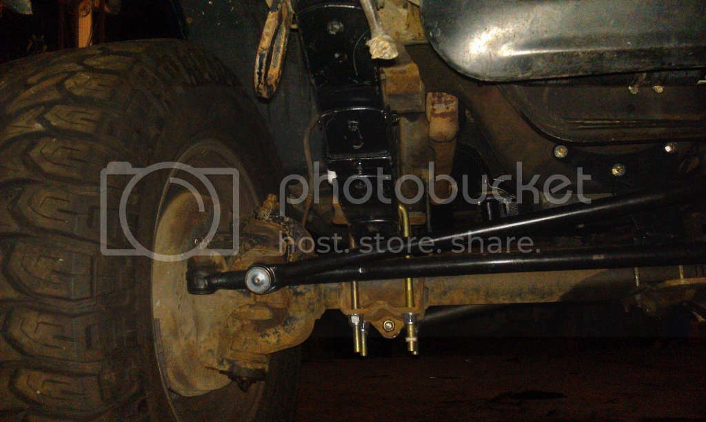

This is My 95 Fummins OBS 60

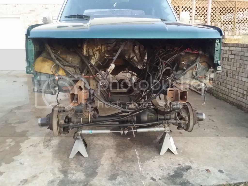

This was my 89 Fummins Superduty 60 center with 95 Knuckles
