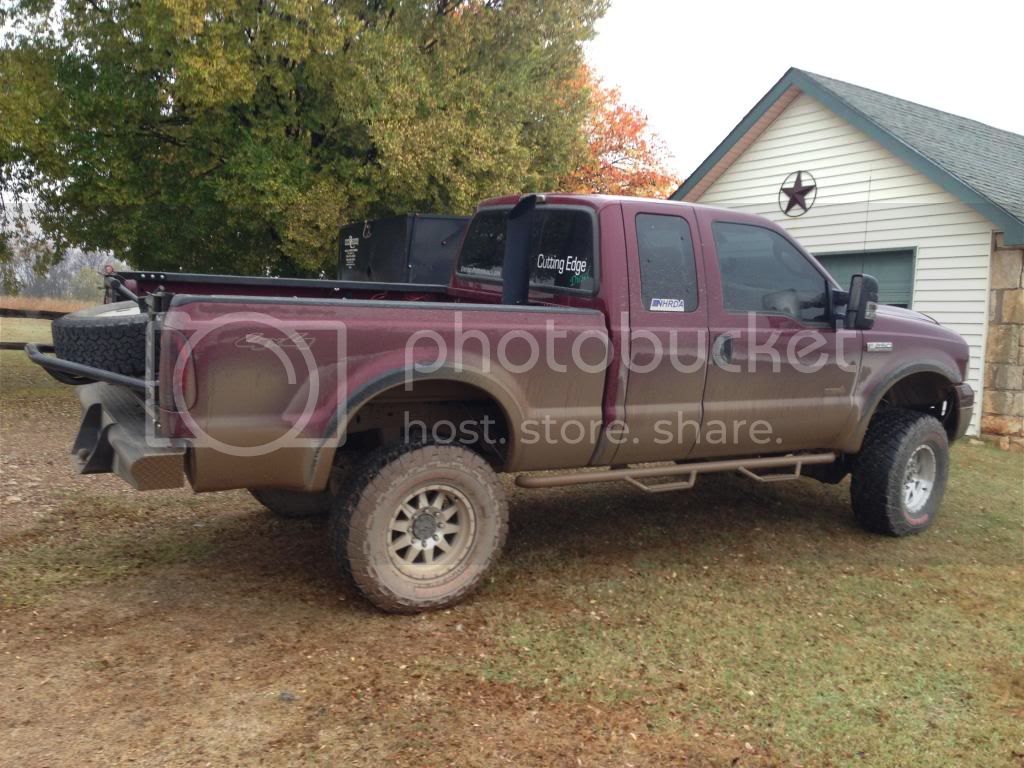

Yup I vote no bumper for now. Glad to hear you like the suspension so much! This truck so far is EXACTLY what I want to do to mine, even have the same bed and cab configuration! The only thing I question is the rear tires look to be favoring the front of the wheel well rather than the center.
Yeah I noticed that too. It will be fixed if we totaly redo the rear suspention
JMart
3,401
DFW
The Axel travels on an arc, not straight up and down. It should center as the springs compress

I want to do something different with the exhaust. Not sure the stack is doing it for me with this project. Anyone have any ideas? Still want to keep a "race" look to it so stock exit is a no go for me on this one.
JMart
3,401
DFW
Flip that elbow upside down and just dump it under the bed. Mine is dumped at the start of the bed with a 45 that is turned about 45* towards the tire.
Powerstroke214
Apr 11, 2012
3,937
Baton Rouge, LA
:whs: or a full dump exhaust(dumping over the axle). I think it'd be perfect, not really noticeable and it sounds good too.
