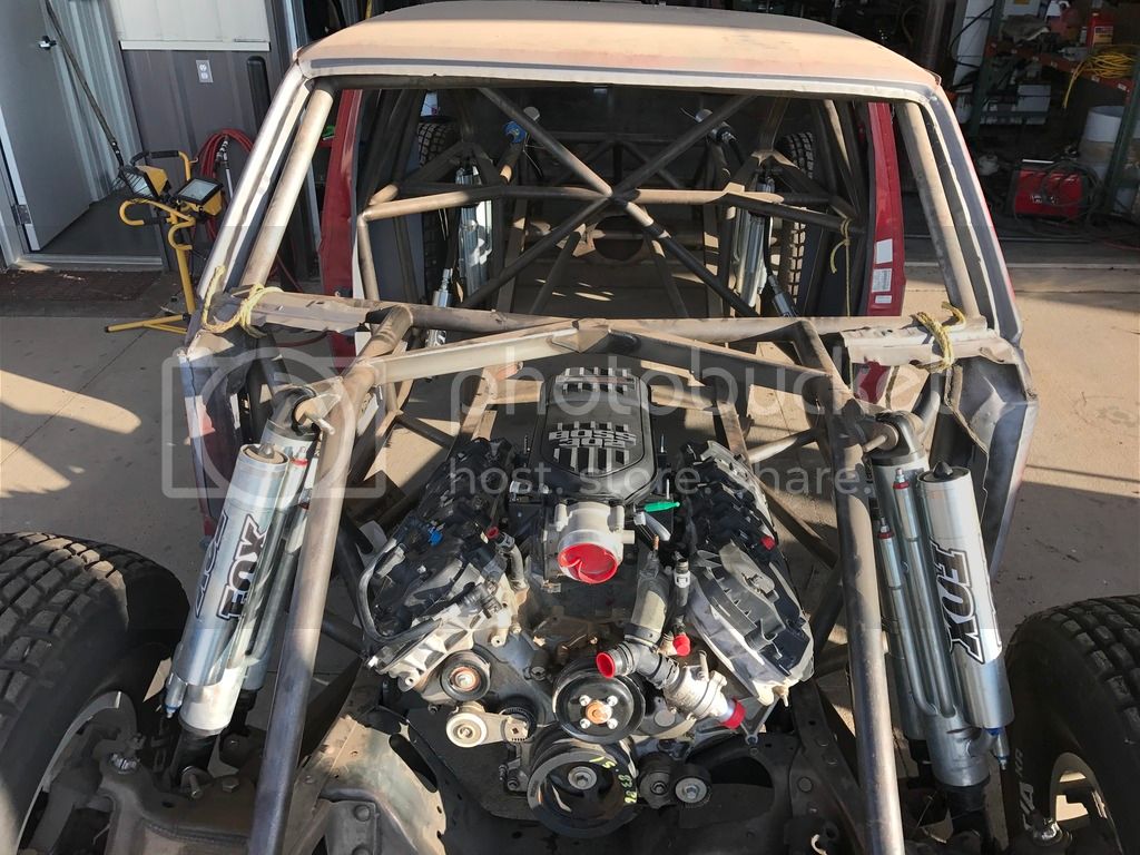

Finally got a chance to mount the motor and trans

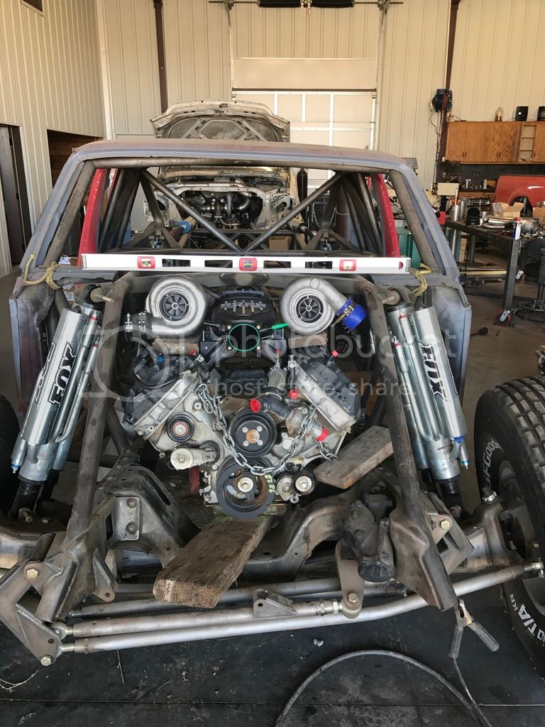

Well that rules out my thought of location then LOL. If ya move the rad and stuff to the rear like the big boys, youd have plenty of room for the turbos. Maybe just run the ic up front to not have the velocity loss from a rear mount.

planning on forged rods and pistons, lower compression valve springs billet oil pump gears, arp everything plus lots of smaller stuff and a pair of SX-E s362s on E85 I hoping to have a safe 700hp and ability to turn it up to 850+ If im feeling like it.
