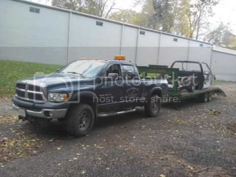

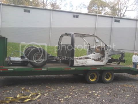

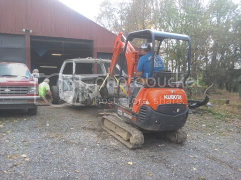

greg and i brought his small enclosed trailer down to swagger shop while my dad and a friend of his brought down his truck with a 20ft gooseneck
got my truck out of the shop and onto the goose neck
i know i know FAIL for having my truck on a trailer behind a cummins
back at the Vernon shop we unloaded the engine, trans and other big parts out of Gregs trailer

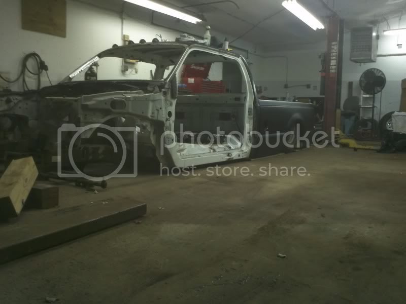

got the truck off the trailer and moved it inside but not in place
headed back to the swagger shop for the mini excavator and more parts

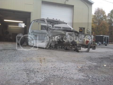

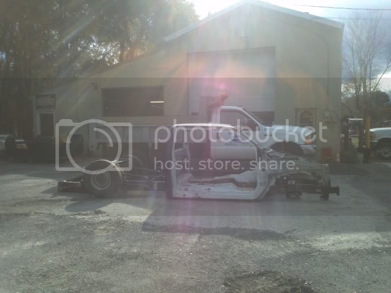

a pic of the truck laid out in front of the vernon shop

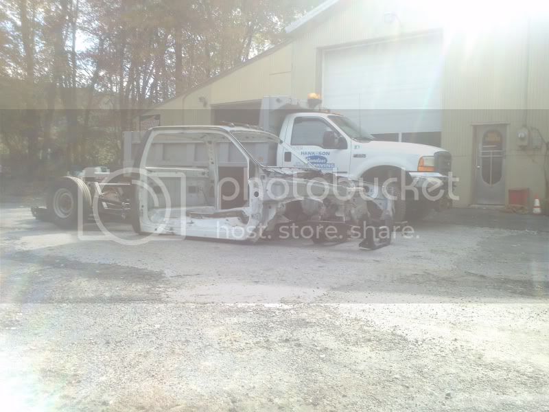

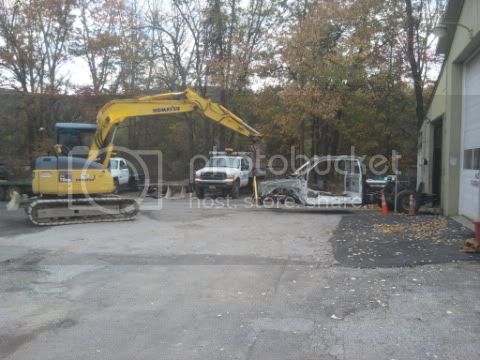

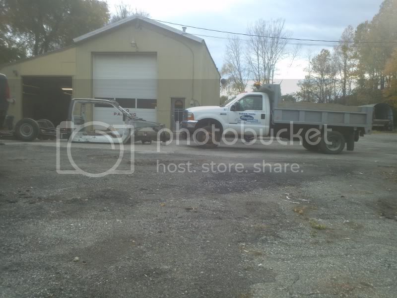

pulled the truck back out to get the bigger ideas in the shop behind it
while it was out i took some pics of it parked by our company F550 (same height as gregs f250 with 285's)

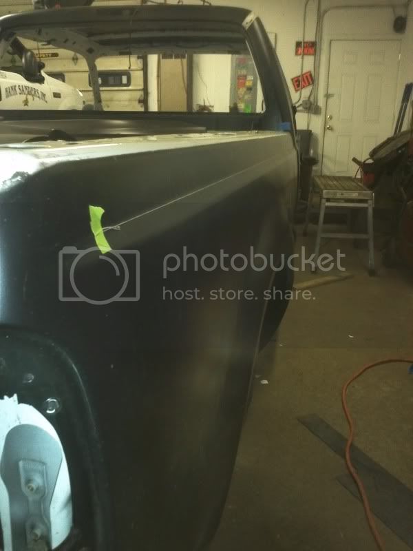

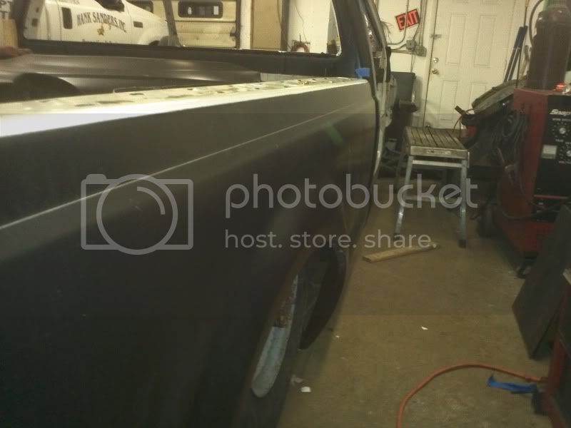

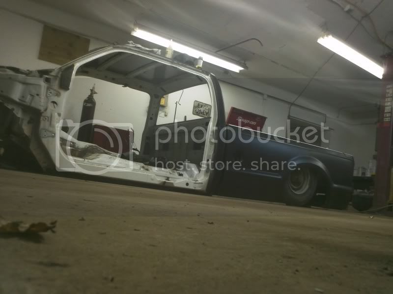

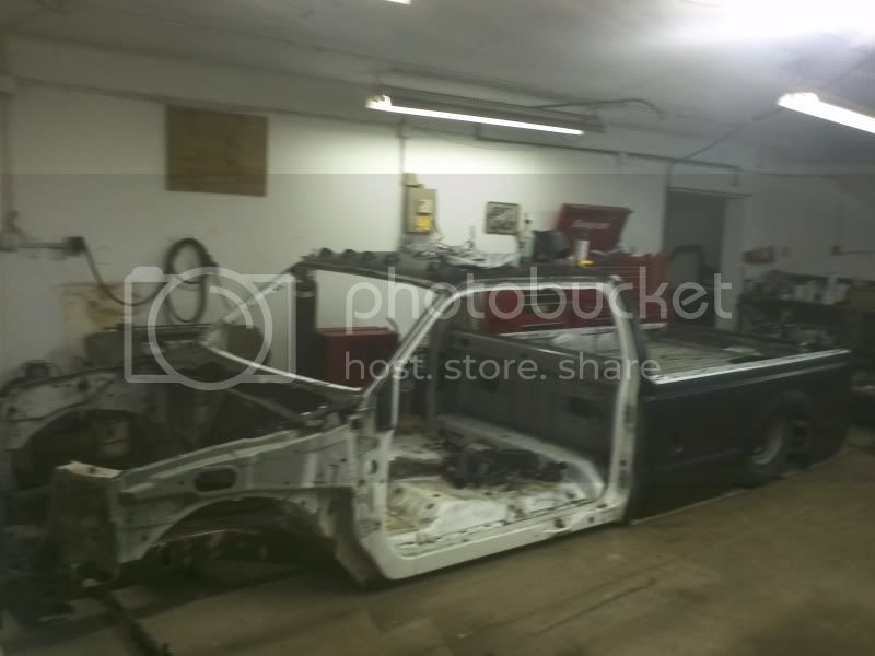

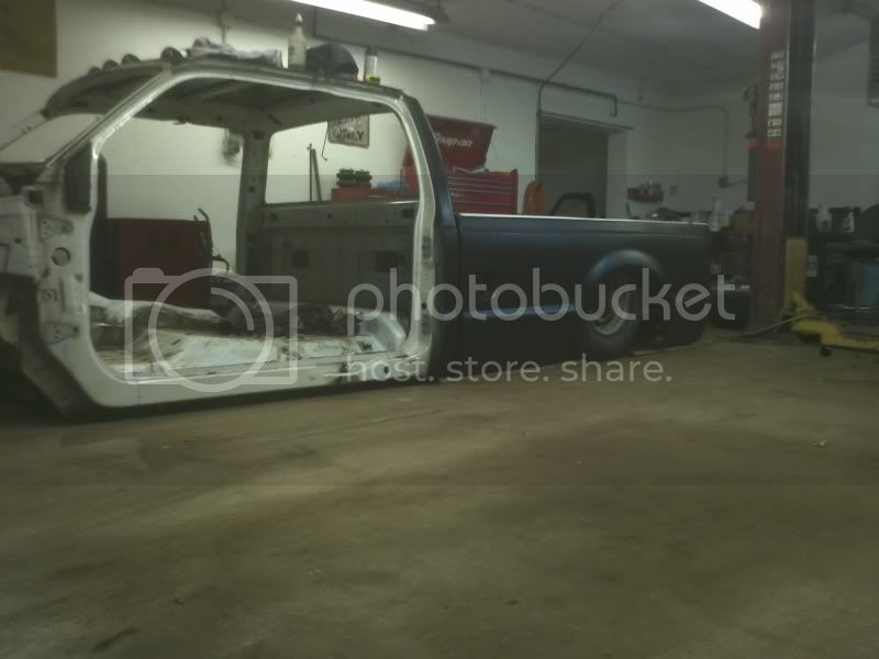

few pics of the bed in place... have to reposition the axle so its centered in the wheel well better but im soooo excited about how it looks

got the bed all lined up ... what a PITA that was alone
the passengers side mount is under the bed and tack welded in place
the body lines line up better now than they ever did
