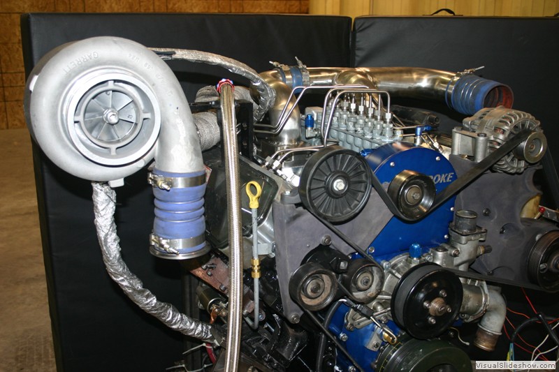

Here u go

What are they running for a HPFP? In order to hit the 1500 hp mark with a 7.3 I would think two pumps would not be enough. some of the 6.4 guys run out of fuel around 1100 to 1200 hp (RWHP) with two pumps. a 7.3 will take more fuel to make the same power would it not???
Strokin6.4
Apr 19, 2012
1,117
I don't believe anyone has maxed a 6.4s fuel capabilities with dual fuelers. Most run 100% nozzles with them and that enough fuel for 1300hp on spray and 1284hp with 4 turboes and I think Nick said it still would clean that up. Dual k16s handle 150% nozzles too but no one has needed that much fuel yet.
TyCorr
Jun 23, 2011
15,461
I thought people were running out of air, hence the nitrous, with dual fuelers as explained above. I highly doubt 1200hp is the max of two pumps.
