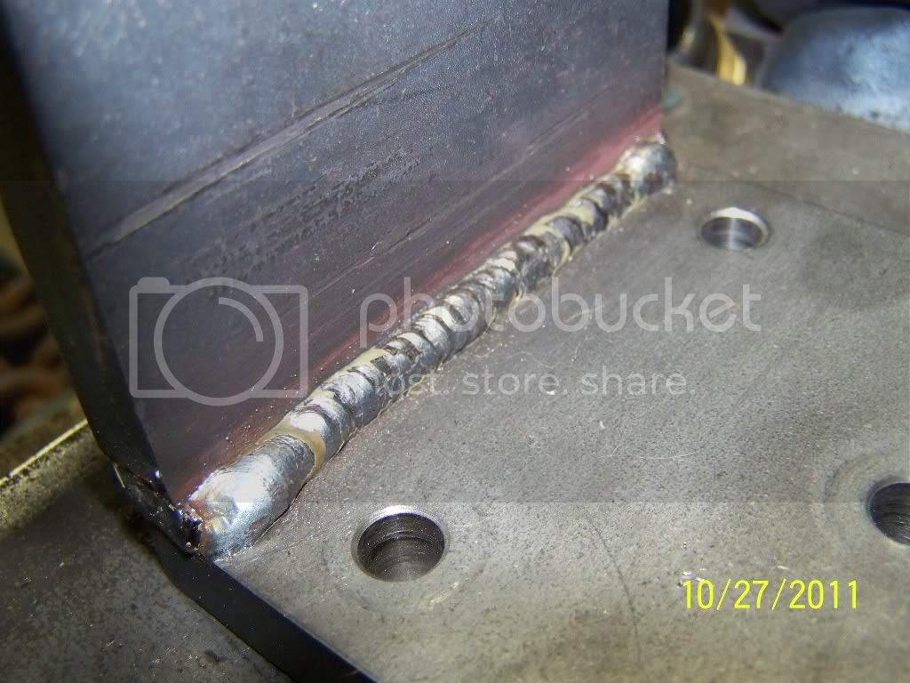

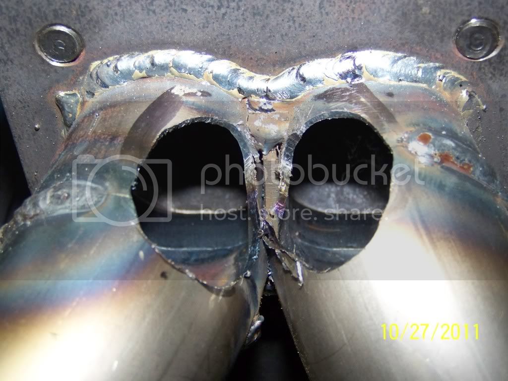

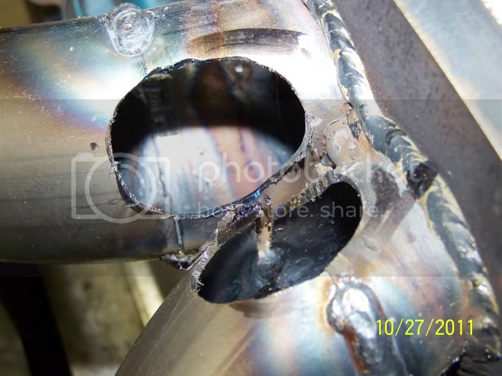

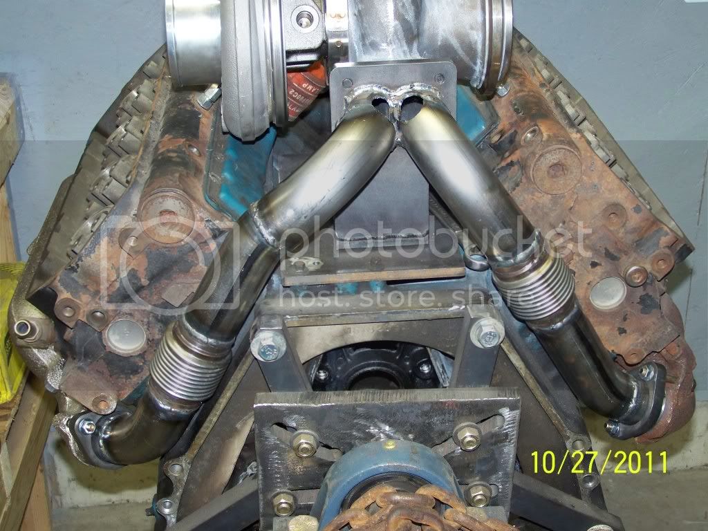

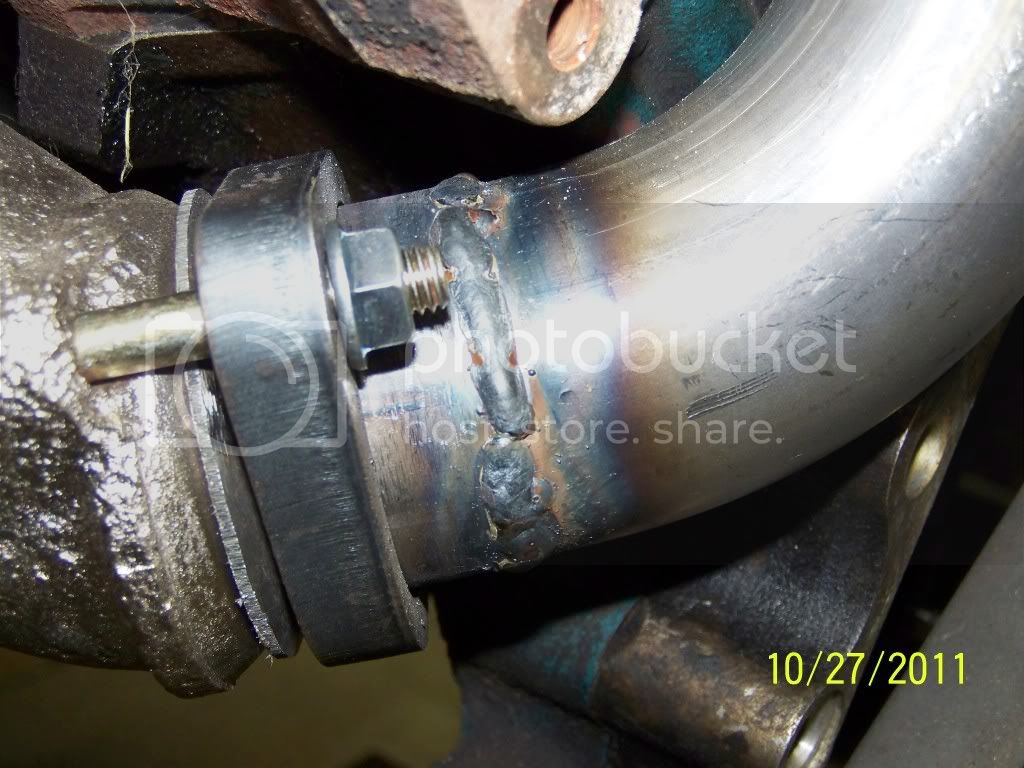

I just purchased a t-4 mount and up pipes when i received them , the first thing i thought is this company needs some welding training ,im posting some pics to get your opinion , i was planning to build my own up pipes but was on a tight schedule and heard good words about these pipes so i bought them and now regret it............

i feel the pipes and base plate are going to break when i fire the truck up the company wants more money to reweld!!!!!!!!!!!!!!!!!!!!!!!!!!!! bs

im 16 and have been learning welding in school for 3 years now and they look like a 2 year old did them. they could of been done 10times better for sure. defently dissapointed, i would be!:doh:

those are very poor quality welds. ill tig you ones that will be SEMA quality, looks like that company needs to step up there game...:shrug:

Not hard to find a good welder, but you have to pay them. The welds on that piece look rushed. Time is money you know. The only ones I might be concerned with are the ones on the base, needs a couple more passes. Youll never see it after its installed, or is this a show piece?

Are the holes for the wastegate?
Yes, cutout for a wastegate.

cold lap mean anything?
OP: Just grind them down, get rid of the poor penetrated cold lap beads and reweld them with tig on the pipes and 7018 on the plate and collector. The hard part is actually putting/fitting it all together. I could reweld all of that in about 20 minutes.

They are my up-pipes. And he was offered to send them in and we would correct the welds. At no charge! I never told him it would cost more to have the weld corrected, a few minutes with the tig machine and they would be smoothed out and flowed together. Yes, the issue should have been fixed before it was sent out. I got in a hurry and didn't inspect the pipes well enough trying to rush them out to the OP by the weekend. This is also why all the pipes are going to begin being tig welded, as the 321ss up-pipes are. Much easier to control the bead on a thin but jointed piece of metal with an ever changing weld angle.

I would not be convinced that the turbo mount will stand the test of time without some work on the welds there so you might want to re-weld that too. Nice to see you jump in the way you did and make this right.
