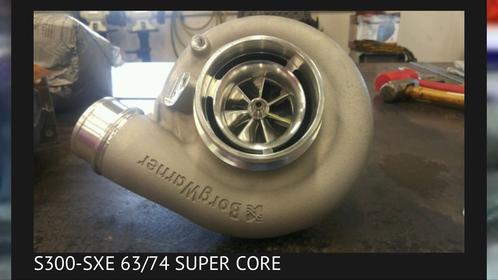

Unless they recently added the smaller ones. I thought only the 364.5-369 were available with 74mm turbines. Last i looked anyways. Someone correct me if I'm wrong.
The Brad
Feb 5, 2014
375
People's Republic of CA
The 363 can be had with the 74mm turbine, but the 362 is only available with the 68mm.
