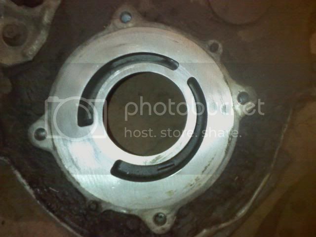

To me it sounds like a LPOP issue, maybe something in the pump let go and is now crashing around at idle?
First, no this is not installed, nor will ever be, on anything I own. Just parts I got with an engine I bought.
But, if anything inside the LPOP broke, I think it would immediately score the chit outa the front cover. After that happens I doubt it'd be able to pull oil or build pressure.
Not to mention, there really ain't much to it... The parts might wear, but I don't see anything breaking.

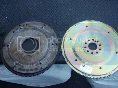

Wandering around on here and went back through some of my old threads...
In case anyone didn't hear... This was a broken flex plate.
I pulled the trans, left it sitting connected to the wiring harness on the floor of the shop, and started the truck with just the adapter holding the starter bolted to the block.
I only visually inspected the flexplate, as I didn't have my TQ wrench and didn't want to take it off without being able to install it to spec.
HRT pulled then engine for me some time ago, and discovered the broken flex plate in the process.
So... Apparently when they break they'll occasionally hold on enough, that you can't see anything under the spacer ring, and the truck will continue to start and drive.
