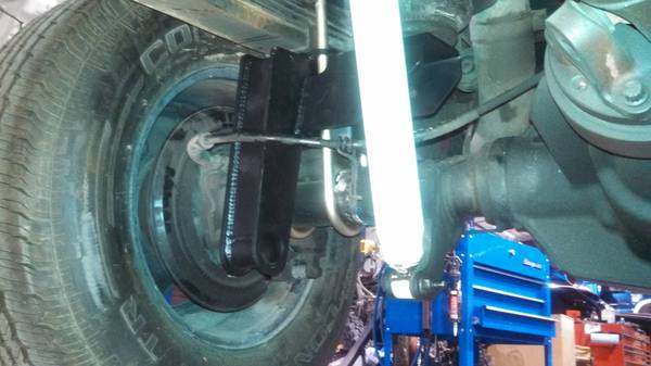

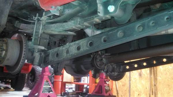

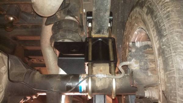

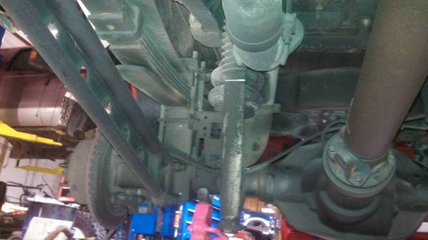

On the truck, I didn't get as far as I would have liked to, but it is mobile again. I forgot I had to break apart the leaf packs to remove the driveline angle wedge, so that took a bit, as did finding the proper location, and drilling for the airbag mount bolt. I got the traction blocks permanently installed, but still have to do the bars and frame mounts. Should be later this week anyway. Here's some pics of before, and so far...
^^^Here's inside the frame rail looking to the RR. When a weld cracked in my prototype converter, it gave the undercarriage a nice "rustproofing". Now it's real fun go clean it up little by little. These fabtech bars have served me well, but I'm really looking forward to the new ones.
^^^outside the frame rail looking into the RR wheel well.
^^^RR corner finished with the air bag re-mounted and the 3/4" U-bolts in place.
^^^I still have a few loose ends on the blocks such as reattaching the brake lines and E-brake cables, but so far, so good. I haven't done too many different traction bar setups, but this is by far my favorite so far.

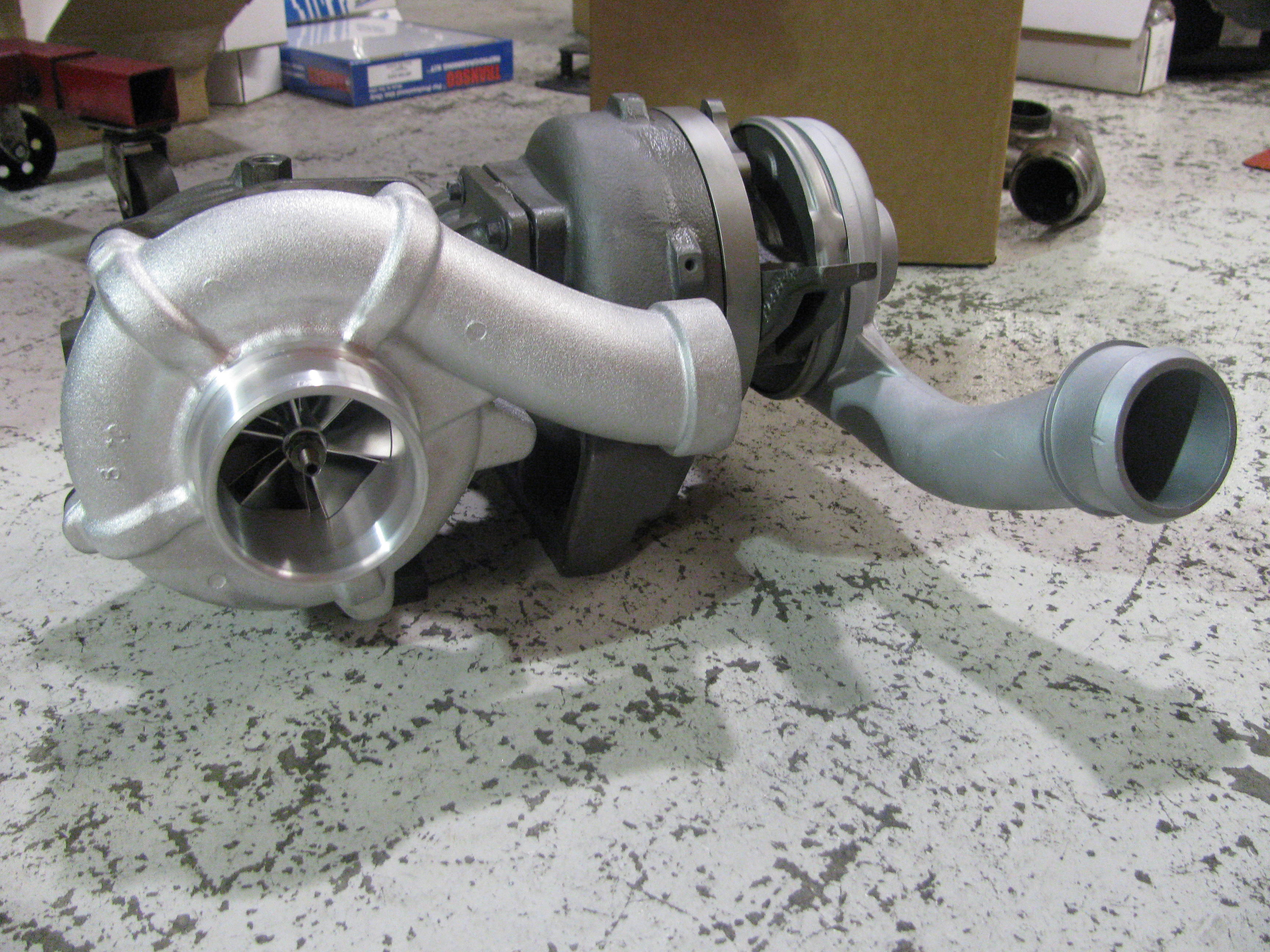

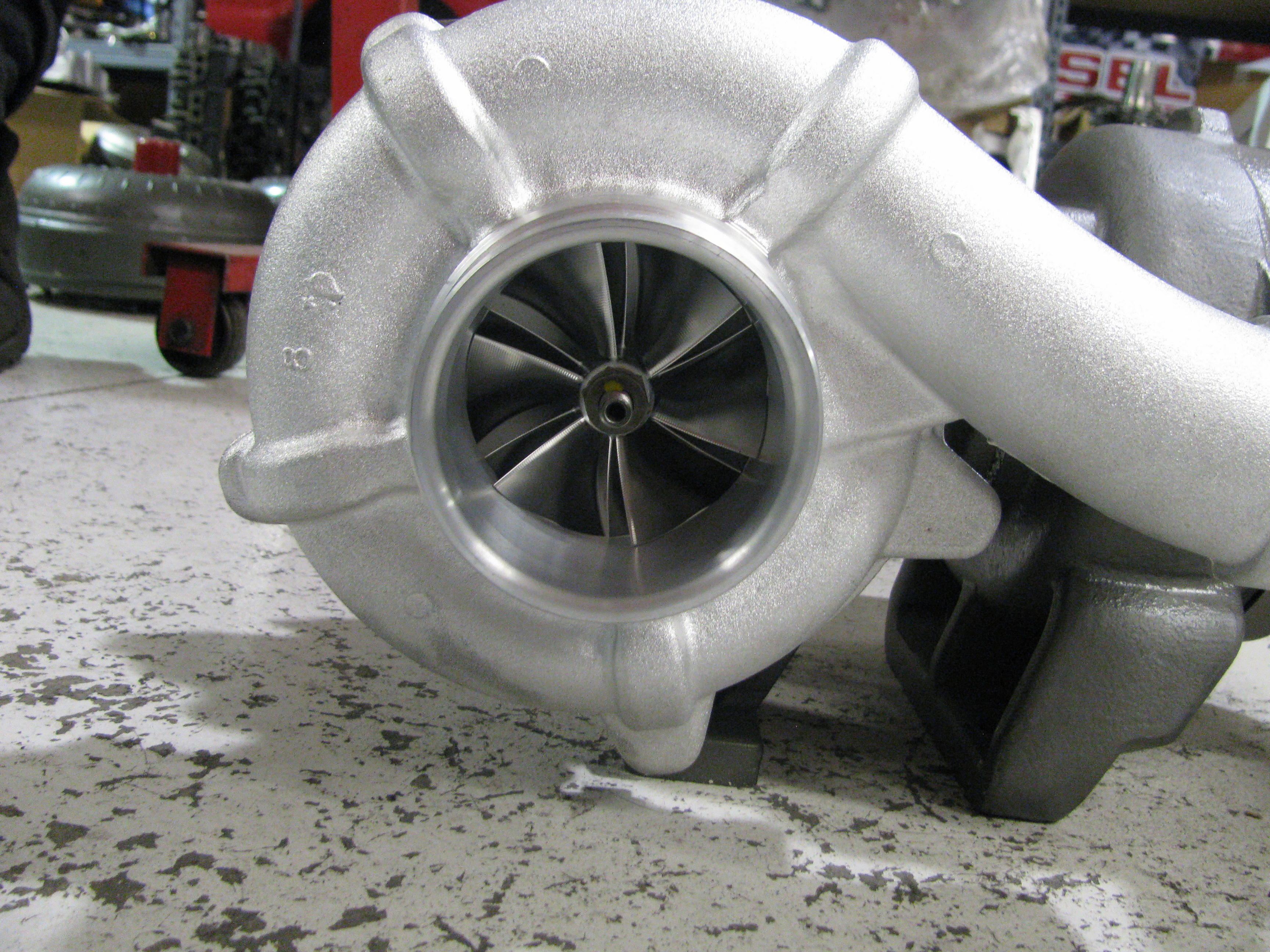

Hoping these help offset Wayne's power loss. 59/76.

So is the inside machined out? Or stock cut off and the 3.5" inlet welded on?
There would be nothing left to machine out as the stock OD is smaller than the new ID :D we've been doing this with the 71 and 72 all along. There's just more involved on this one to make it look and work right

thats what i was thinking was that the 72 was about as big as the stock housing could handle, size wise.

The current setup is same as tow power plus on the billet VGT, but with the atmo being a stock housing hiding a 76 precision CEA compressor wheel among other things. I couldn't get on the dyno today, but did some data logging during lunch, and made 46 psi boost just on the atmo. It looks like time for more fuel now as I can't get it to smoke at all once the converter locks. It's minimal at best before that.
